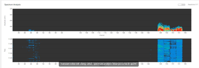

Yes we have
but i think i don't have any knowledge yet about reading this spectrum
can you help us , what's the difference between red,yellow,and green colour?
and also the difference from 2 of spectrum (amplitude vs time & channel vs time)
