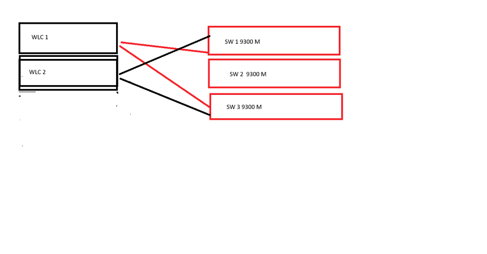

What is the best way to do it?
Should I create a single link to one of the controllers? Or at least establish two links to different stacked switches to achieve some redundancy, where Spanning Tree would block one of the ports?
In this scenario, the issue is that a single link does not provide the same bandwidth as a port-channel with two or three links.athan1234_0-1753094948213.png
Another option would be to add an intermediate switch, create a port-channel between this switch and the Meraki switches, and have all connections go through this intermediate switch.
If SW is stack to each other then your design is optimal.
Wlc will connect using PO to two SW members of stack
That excellent

The issue is that the Meraki switch is not compatible with the required mode On. For this reason, I will need to proceed with a single design.
Sorry for that limitations
So solution
Either use single link
Or as you suggest before use SW inbetween'
This SW have PO (mode ON to each of wlc 5500) and have PO (mode lacp) to switch stack.
MHM
This is a single cable. It is a good idea to have Spanning Tree blocking one port on each link, and for the controller to work with a single link for both the main and backup connections.  The wlc  is backup . The three switches are configured in a stack.
Wlc dont run stp so your last design will make loop' mac of wlc and/or ap and/or wifi users will flapping between two port.
What I meaning by single link is only single link from wlc to any of stack sw.
