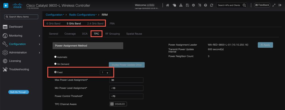

Not really any best practice changes from enterprise and home.  The only thing you can do is tweak the RF.  You can always set your access point to a specific channel and or set RRM to only change every 24 hours.  When I test on a specific ap at home, I would set the channel and set the power level to 1.  When I'm done testing, I would let RRM only change the channel every 24 hours, default is 10 minutes.  Take a look here for changes you can make globally.
Configuration | Radio Configurations | RRM
-Scott
Here are some screens shot from my 9800 Controller, should be the same to the EWC
-Scott
