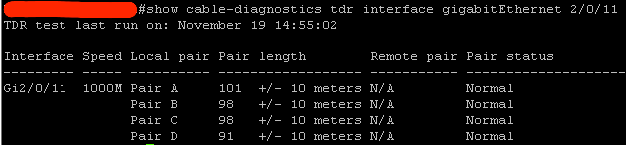

I did a cable test too
Any other things I can try?

Leo Laohoo
101 metres???
Exactly what switch is this and what exact firmware is the switch running on?
It's on a roof, been working for about 4 years.  There are 8 floors in this office, comms is on the 7th.
