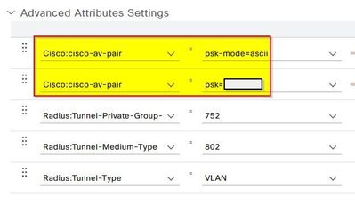

this university hospital recently started to use Identity PSK for IoT-devices.  I changed the configuration of an already existing WLAN for PSK-Authentication of old medical devices not able to use WPA2 in the past, to authenticate now using MAC-authentication-bypass on the ISE. The password and VLAN-information is send by ISE with Cisco-av-pairs and Radius-attributes back to the WLC and the joining WLAN-MAC-address. Works so far so good.

Is it possible within iPSK to allow two different passwords for the same device ?
This would mean a second Cisco av-pair included in the ISE-answer right ?
 Would this be possible ?

              - You can't have iPSK with two passwords; would Multi-PSK , be a feasible solution ?
     Look into https://www.cisco.com/c/en/us/td/docs/wireless/controller/9800/17-12/config-guide/b_wl_17_12_cg/m_multi-preshared_key_or_multi-psk.html
    >...In Multi-PSK, two passwords are configured (deadbeef and beefdead) for the same SSID. In this scenario, clients can connect to the network using either of the passwords.
  Note that  Multi-PSK is different from iPSK. In iPSK, the PSK password comes from ISE authorization policy, so MAB is required. MPSK uses a pool of passwords locally configured in WLAN, so ISE is not used.
