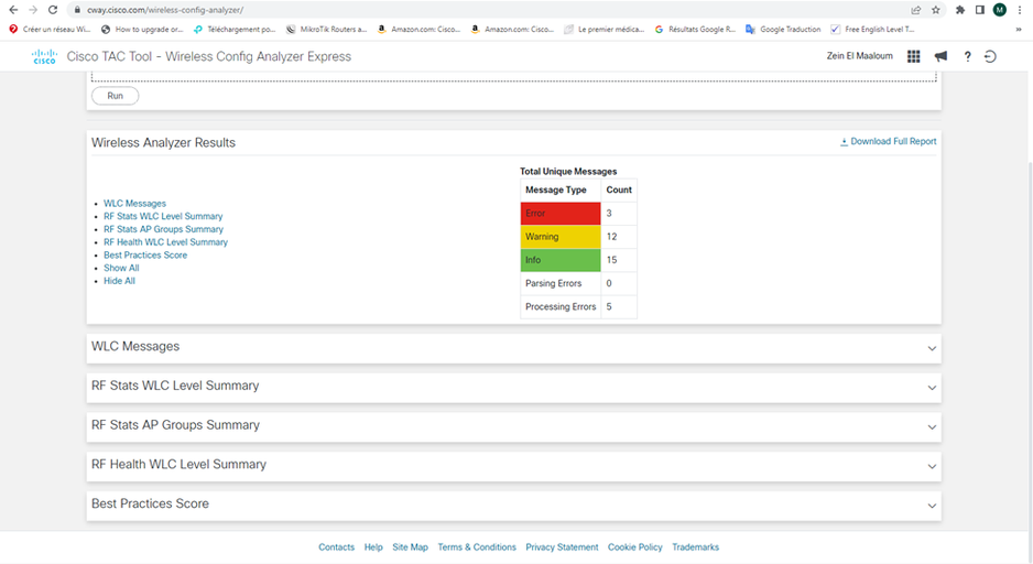

I didn't quite understand!
Do I have to save the vWLC configuration in a .text file then the analyzer will analyze the configuration from the .text file?
 - Yes , but if you use TFTP to upload the configuration then you will have the needed text file automatically ,
 M.
ok I Upload file (Config03012023)  on the analyzer and I did run, but no massage after !
 - Attach it here , I could review it and or try myself ,
 M.

 - Doesn't seem to work indeed , it also seems incomplete as it does not contain administrative authentication info's etc. Please try the show run-config method with no breaks as mentioned in https://community.cisco.com/t5/networking-knowledge-base/show-the-complete-configuration-without-breaks-pauses-on-cisco/ta-p/3115114#toc-hId-1039672820  , the output (also) needs to be saved in a text file (indeed) , but if you connect to the controller with tools such as PuTTY you can configure to keep an operator log , to save all outputs (for instance) , of course when disconnecting from the controller you then need to clean it up a bit before providing the configuration-only data  to the WirelessAnalyzer tool.
 M.
 - This is only a partial screenshot , open panes accordingly and at least all red-flagged items should be corrected , (open the other yellow advisories too and correct according to urgency)
 M.
According to the 1st message, I have to migrate to version 8.10, but I couldn't download because as I don’t have Service Contract!
  - That is beyond my resolving capabilities , you could contact TAC and or argue business need (f)or testing , or saying you have an important security problem, they are sensitive to that ,
 M.
