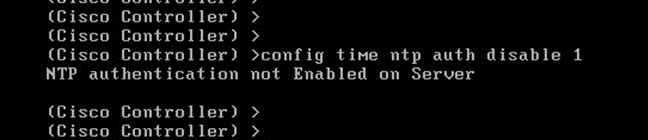

 - FYI : https://www.cisco.com/c/en/us/td/docs/wireless/controller/7-3/configuration/guide/b_cg73/b_wlc-cg_chapter_010.html#ID1009 , make sure NTP is not used and or disabled ,
 M.
dose this is correct?
 - No that is unrelated , anyway normally NTP will not be enabled upon an initial configuration anyway , so you don't need to worry , use command Show Run-config  (CLI) to verify (further) that no NTP settings are being applied ,
 M.
I don’t find NTP on the Show Run-config (CLI) list.
