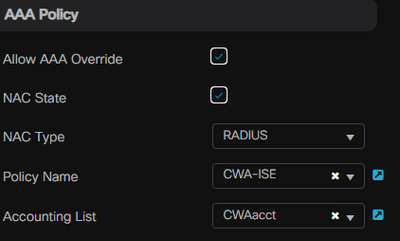

seems good so far, assuming there is no additional ACLs or Firewall, http service is enabled, AAA overide and NAC state is enabled, if you paste the url from ISE into clients browser is it reaching the redirect page ?

Yes, it does reach the page when i copy it the URL to the client. I do have ip http server, and webauth-http-enable is not in the config like the guide said. Is there anything that might be causing this? Or anything that might help shed light on this?
