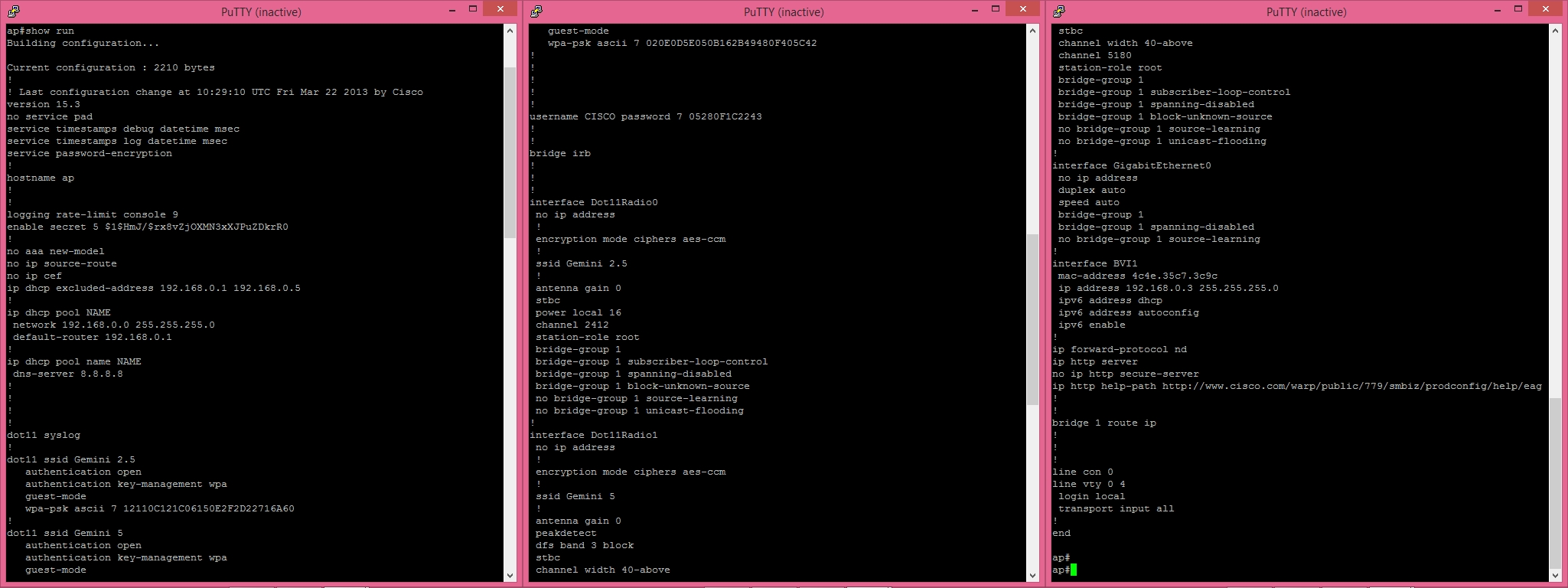

I added the google DNS server but nothing changed. Chrome still gave me the DNS error and only Viber can access the internet. Here is the screen shot of the show run of the AP.
And here is the show run of the other AP that works fine. I don't know what caused the above AP (Gemini) not to work properly.
Hi
I think I made a typo in my config. Try below & see.
conf t
no ip dhcp pool name NAME
ip dhcp pool NAME
dns-server 8.8.8.8
exit
wr mem
Should work this time :)
HTH
Rasika
*** Pls rate all useful responses ****
Nope.... not working
