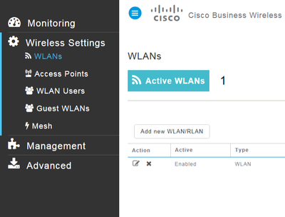

I had looked everywhere in the access point (primary) and I never saw what was listed in the document above.  The problem is that the AC240 page where it lists access points (when you connect to your primary AP) does not render properly in traditional Internet Explorer.  I was managing the AP from a remote location's jumpbox which only has bare minimum tools since its a domain controller as well.  This is what that page looks like when you click on Access Points in Internet Explorer.
I then went and installed Chrome (Firefox complains about the certificate) and tried the same and it rendered the page correctly and I was able to apply the IP address settings and access numerous other functions.  Bottom line, it won't render properly with Internet Explorer and you will not be able to administer the AP completely unless you use a different browser.
