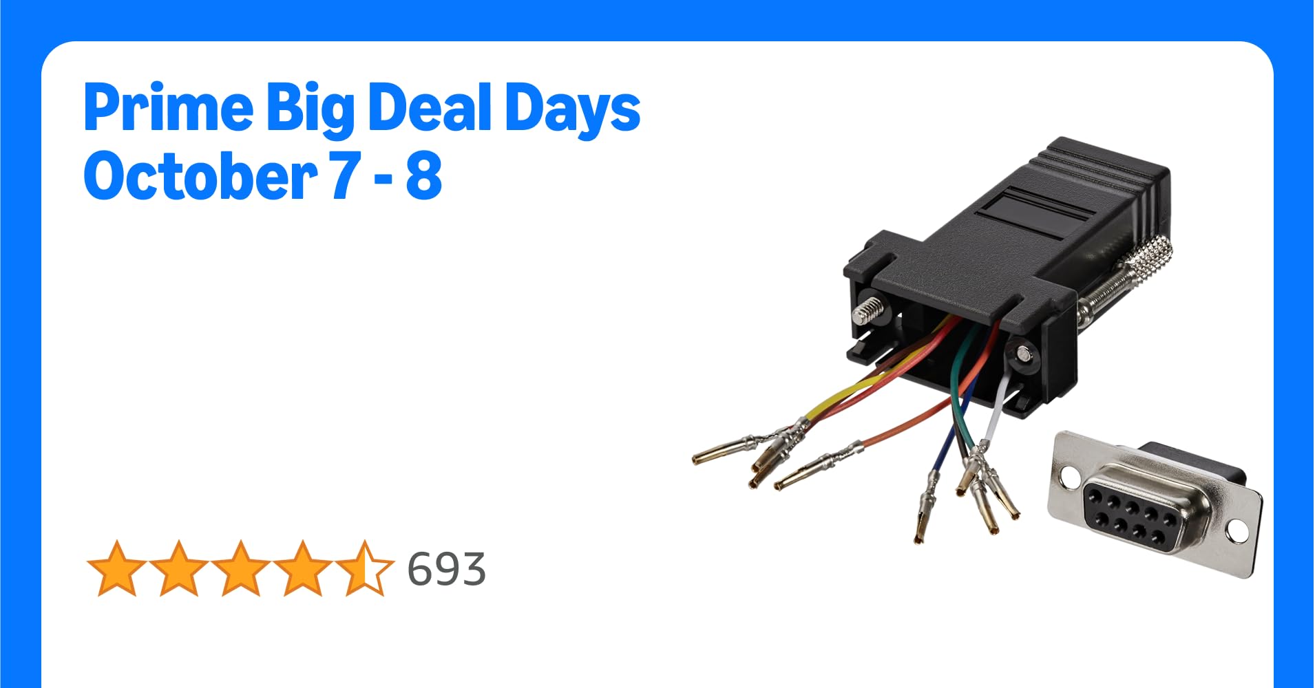

Thanks for this info. I am pretty sure its down to the DB9 to RJ45 adaptors I have been using as they dont work on my console to USB nor my Opengear console server. I have just got a few of the below so I can make the correct pins outs and hopefully gets console access sorted
https://www.amazon.co.uk/gp/product/B00006IRQA/ref=ppx_yo_dt_b_asin_title_o00_s00?ie=UTF8&psc=1
Many thanks

All these forum posts talking about the 8510 serial all mention that you need another adapter. But none of them mention which one was bought, or what the cable layout should be for a "modular" one like the one above ...
Does anyone know ?
Thanks
