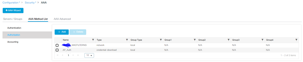

I setup WLC9800 manually, (please see my screen shots) but when I enable the AP Policy, AP is disjoin.
Log: *Jul 31 2023 16:58:26.758: %CAPWAPAC_SMGR_TRACE_MESSAGE-5-AP_JOIN_DISJOIN: Chassis 1 R0/0: wncd: AP Event: AP Name: AP00EA.BD12.804C Mac: 706d.158c.4320 Session-IP: 10.150.80.100[5264] 10.150.80.50[5246] Disjoined AP Auth Failure.
When I disable the AAA, AP is successfully joined. What did I missed..?

which mac address did you add on the Access List? It must  be the ethernet mac address
On the access list, I put device ethernet mac address.
Actually I tried bssid too, but obviously didn't work.
I tried 'without seperate' or 'xx:xx:xx:xx:xx', 'xx-xx-xx-xx-xx-xx', 'xxxx.xxxx.xxxx' , result is same.
WLC controller time is local time, but should I check the AP side either?
Actually, without AAA (authrozied AP) AP is join... I don't know what did I miss or mis-configured.
