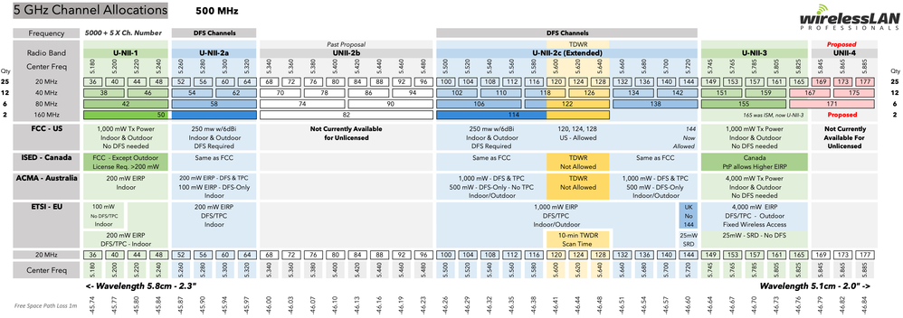

Yes, in the given list channel 116 & channel 140 does not have a secondary channel if you want to go with 40MHz. Try remove those two channels from your DCA list
Here is the 5GHz spectrum (You can get a copy from WLAN Professional site - Thank you Keith)
HTH

Is channel 120 selected? It needs to be if 116 is also selected if width is 40 MHz.
HTH
Rasika
*** Pls rate all useful respones ***
Thank you dear. I remove The channels 116 and 140. Its works. Thank you
