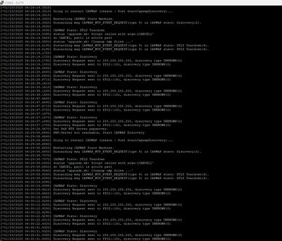

Hi there,
I am new on cisco and I have cisco 9120AXE-F and it's new. To power on the product, I connect to POE+ injector AIR-PWRINJ6 and for configure I have console cable to usb with my laptop and it is running well and i can see boot process for the it. Then I dont know why it is stuck on this with 2 hours i am waiting :

[*01/22/2025 09:58:36.3190] GCM-128 POST passed
[*01/22/2025 09:58:36.3190] GCM-256 POST passed
[*01/22/[ OK ] Started Cisco system time setup.
▒▒5▒j OK ] Started Cisco fips check.eneration.
[ OK ] Started Cisco seed generation.
Starting Cisco btldr service...
[*01/22/2025 09:58:36.6710]
[*01/22/2025 09:58:36.6710] [1/22/2025 9:59:37] : Shadow is now in-synced with master
[ OK ] Started Cisco btldr service.
[ OK ] Reached target Local File Systems.
*Starting Cisco system time saving...ving.
Starting Cisco pkg install service...
Starting Cisco act2 check...
Starting Cisco S10 boot service...
[01/22/2025 09:58:37.4630] bcmlibs: module license 'Proprietary' taints kernel.
[01/22/2025 09:58:37.5410] Disabling lock debugging due to kernel taint
[01/22/2025 09:58:37.9380] bm_base_addr 0xffffffc006000000, size 67108864, bm_base_addr_phys 0x0000000006000000
[01/22/2025 09:58:38.0490] fm_base_addr 0xffffffc002e00000, size 12582912, fm_base_addr_phys 0x0000000002e00000
[01/22/2025 09:58:38.8740] Broadcom Command List Driver v1.0
[01/22/2025 09:58:38.9550] crossbar[0]: Allocated cb_idx=0 int_ep=0
[01/22/2025 09:58:39.0200] crossbar[0]: Add cb_idx=0 ext_ep=0 SERDES:6
[01/22/2025 09:58:39.0950]
[01/22/2025 09:58:39.0950] Detecting PHYs...
[01/22/2025 09:58:39.1730] Lift PHY at address 31 out of Reset by GPIO:31 Active Low
[01/22/2025 09:58:39.2700] 54991EL B0 3590:5089 --> 0x1f
[01/22/2025 09:58:39.3270]
[01/22/2025 09:58:39.3270] Loading firmware into detected PHYs...
[01/22/2025 09:58:39.4570] Firmware version: Blackfin B0 v02-02-03-2020-03-16
[01/22/2025 09:58:39.5390] Loading firmware into PHYs: map=0x80000000 count=1
[01/22/2025 09:58:39.6220] Halt the PHYs processors operation
[01/22/2025 09:58:39.6900] Upload the firmware into the on-chip memory
79%/22/2025 09:58:39.7630]
[01/22/2025 09:58:42.3810] audit_printk_skb: 102 callbacks suppressed
84%[01/22/2025 09:58:42.4500]
88%stall service.Cisco pkg in
100%
[01/22/2025 09:58:43.1060] Reset the processors to start execution of the code in the on-chip memory
[01/22/2025 09:58:43.2120] Verify that the processors are running: OK
[01/22/2025 09:58:43.7610] Verify that the firmware has been loaded with good CRC: OK
[01/22/2025 09:58:43.8480] Firmware loading completed successfully
[01/22/2025 09:58:43.9500] Adjusted SF2 SGPHY: sphy_ctrl=0x00010c1b
[01/22/2025 09:58:44.0350] getrcal for res select 5, int 663, ext 651, ratio 125 ratio1 140, rcal 8
[01/22/2025 09:58:44.1330] Setting SGMII Calibration value to 0x8
[01/22/2025 09:58:44.2030] PLL_PON(8051): 0x0210; TX_PON(8067): 0x0040; RX_PON(80b2): 0x0880
[01/22/2025 09:58:44.8310] dgasp: kerSysRegisterDyingGaspHandler: bcmsw registered
[ OK ] Started Cisco S10 boot service.
Starting Cisco watchdog...
Starting Cisco marlin_sia module service...
Starting Cisco nolan service...
Starting Cisco nss service...
[ OK ] Started Cisco watchdog.
[ OK ] Started Cisco nolan service.
[ OK ] Started Cisco nss service.
Starting Cisco S15platform...
Starting Cisco Kclick...
[*01/22/2025 09:58:37.2190] 13
[*01/22/2025 09:58:37.2910] Active version: 17.6.4.56
[*01/22/2025 09:58:37.2930] Backup version: 0.0.0.0
[*01/22/2025 09:58:37.4500] Loading BCM modules ...
[*01/22/2025 09:58:37.4500] Ignore pptp.ko
[*01/22/2025 09:58:37.4520] Ignore pktflow.ko
[*01/22/2025 09:58:37.4540] Ignore pktrunner.ko
[*01/22/2025 09:58:37.4560] Load bcmlibs.ko
[*01/22/2025 09:58:37.6170] BCMLIBS loaded...
[*01/22/2025 09:58:37.6280] Load wlcsm.ko
[*01/22/2025 09:58:37.6520] Load rdp_fpm.ko
[*01/22/2025 09:58:37.6960] Load bdmf.ko
[*01/22/2025 09:58:37.7210] Load proclikefs.ko
[*01/22/2025 09:58:37.7400] Load rdpa_gpl.ko
[*01/22/2025 09:58:37.7620] Load rdpa_gpl_ext.ko
[*01/22/2025 09:58:37.7790] Load rdpa.ko
[*01/22/2025 09:58:37.8430] Load rdpa_usr.ko
[*01/22/2025 09:58:37.8650] Load rdpa_mw.ko
[*01/22/2025 09:58:38.1670] RDP Physical address=0x82200000 Virtual address = 0xffffff8001c80000
[*01/22/2025 09:58:38.1800] configure_runner: NATC keysize 0x100070 key element size 16 contextsize 0x400000 context element size 64
[*01/22/2025 09:58:38.1800] ++++Runner gso_desc_pool created successfully
[*01/22/2025 09:58:38.2020] rdd_init_params.runner_nat_cache_key_ptr=0xffffffc003700000
[*01/22/2025 09:58:38.2020] rdd_init_params.runner_nat_cache_context_ptr=0xffffffc002e00000
[*01/22/2025 09:58:38.2020] rdd_init_params.runner_context_cont_ptr=0xffffffc003200000
[*01/22/2025 09:58:38.6670] FPM_BPM phy_addr 0x82c30000,virt_addr 0xffffff80018fe000
[*01/22/2025 09:58:38.6680]
[*01/22/2025 09:58:38.6680] RDP PKT memory = 64MB : Max Possible Bufs <16384> of size <4096>; Allocating <15360> bufs; RDP enum <5>
[*01/22/2025 09:58:38.8220] Load chipinfo.ko
[*01/22/2025 09:58:38.8290] brcmchipinfo: brcm_chipinfo_init entry
[*01/22/2025 09:58:38.8400] Load rdpa_cmd.ko
[*01/22/2025 09:58:38.8650] Load cmdlist.ko
[*01/22/2025 09:58:38.9420] Load bcm_enet.ko
[*01/22/2025 09:58:39.0950] crossbar Mux: connect cb_idx:0 int_ep 0 to ext_ep 0
[*01/22/2025 09:58:39.0950] crossbar Mux: connect cb_idx:0 int_ep 1 to ext_ep 2
[*01/22/2025 09:58:41.8150]
[*01/22/2025 09:58:41.8150] Authenticating ACT2 ID:C9120
[*01/22/2025 09:58:41.8150] Authenticating SN:FOC27253E8S
[*01/22/2025 09:58:41.8150] (ACT2Boot) Hardware is Cisco (c) authentic
[*01/22/2025 09:58:41.8210] Seeding /dev/urandom from ACT2
[*01/22/2025 09:58:43.3500] Reading ACT2 SUDI certificates
[*01/22/2025 09:58:44.0220] NOTE: Using Port Grouping for IMP ports : [ 0 --> 4 ] [ 1, 2 --> 5 ] [ 3, 7 --> 8 ]
[*01/22/2025 09:58:44.8310] eth0: Down <58:8B:1C:B6:3C:90> <ExtSw P0, Logical 08> PHY_ID <0x0007f008:0x08: On-chip 1G GPHY> Cfg: ANG.1G; Down
[*01/22/2025 09:58:44.8310] eth1: Down <58:8B:1C:B6:3C:90> <ExtSw P1, Logical 09> PHY_ID <0x0007f009:0x09: On-chip 1G GPHY> Cfg: ANG.1G; Down
[*01/22/2025 09:58:44.8310] eth2: Down <58:8B:1C:B6:3C:90> <ExtSw P2, Logical 10> PHY_ID <0x0007f00a:0x0a: On-chip 1G GPHY> Cfg: ANG.1G; Down
[*01/22/2025 09:58:44.8310] eth3: Down <58:8B:1C:B6:3C:90> <ExtSw P3, Logical 11> PHY_ID <0x0007f00b:0x0b: On-chip 1G GPHY> Cfg: ANG.1G; Down
[*01/22/2025 09:58:44.8310] eth4: Down <58:8B:1C:B6:3C:90> <ExtSw P7, Logical 15>
[*01/22/2025 09:58:44.8310] Chip Port 9, CrossBar Port 0, PHY_ID <0x06100006:0x06: On-chip 2.5G SERDES> Cfg: ANG.2.5G; Down
[*01/22/2025 09:58:44.8310] PHY_ID <0x0388001f:0x1f:External Cascaded 10G EXT3> Cfg: ANG.2.5G; Down
[*01/22/2025 09:58:44.8310] ===> Activate Deep Green Mode
[*01/22/2025 09:58:44.8310] bcmswlpbk0 (Ext switch port: (Logical Port: Virtual link DOWN
[*01/22/2025 09:58:44.9130] bcm_enet_init:L2672 ENET system contructed and configured enet-kthrd thread
[*01/22/2025 09:58:44.9130] enet_kthread_handler:L326 Instantiating ENET thread
[*01/22/2025 09:58:44.9350] open </dev/fcache> error no 2
[*01/22/2025 09:58:44.9350] fcctl: failed to disable hw acceleration
[*01/22/2025 09:58:44.9350] fcctl: failed to configure Flow Cache
[*01/22/2025 09:58:44.9360] open </dev/fcache> error no 2
[*01/22/2025 09:58:44.9360] fcctl: failed to disable Flow Cache
[*01/22/2025 09:58:44.9370]
[*01/22/2025 09:58:44.9370] open </dev/fcache> error no 2
[*01/22/2025 09:58:44.9370] fcctl: failed to flush Flow Cache entries Broadcom Packet Flow Cache flushing the flows
[*01/22/2025 09:58:44.9510] Auto Detection of Serdes: Enabled
[*01/22/2025 09:58:44.9510] PHY Capabilities: 2.5GFD|1GFD|100MFD
[*01/22/2025 09:58:44.9510] Link is Down.
[*01/22/2025 09:58:45.0700] ret code = 0.
[*01/22/2025 09:58:45.0750] wired0 Link encap:Ethernet HWaddr 58:8B:1C:B6:3C:90
[*01/22/2025 09:58:45.0750] UP BROADCAST MULTICAST MTU:2044 Metric:1
[*01/22/2025 09:58:45.0750] RX packets:0 errors:0 dropped:0 overruns:0 frame:0
[*01/22/2025 09:58:45.0750] TX packets:0 errors:0 dropped:0 overruns:0 carrier:0
[*01/22/2025 09:58:45.0750] collisions:0 txqueuelen:1000
[*01/22/2025 09:58:45.0750] RX bytes:0 (0.0 B) TX bytes:0 (0.0 B)
[*01/22/2025 09:58:45.0770] 58:8B:1C:B6:3C:90
[*01/22/2025 09:58:45.0770] BCM11ax AP: MIC Certificate Present
[*07/06/2023 23:59:59.0070] Last reload time: Jan 22 09:58:36 2025
[*01/22/2025 09:58:36.0000] Setting system time Wed Jan 22 09:58:36 UTC 2025
[*01/22/2025 09:58:36.5370] Last reload reason : 0: unknown
[*01/22/2025 09:58:37.1410] Loading HND Module
[*01/22/2025 09:58:37.2900] stile module dp init successfully
[*01/22/2025 09:58:37.2900] NBAR Label:BLD_POLARIS_DEV_LATEST_20200414_053707 Module timestamp: Aug 10 2022 at 23:37:34 User: ttaichol
[*01/22/2025 09:58:38.2660]
[*01/22/2025 09:58:38.2660] ACT2 Check passed
[*01/22/2025 09:58:39.0720] Starting check if backup WiFi NVRAM are available
[*01/22/2025 09:58:39.0720] WiFi backup nvram - crc = 4155980973
[*01/22/2025 09:58:39.0720] WiFi active nvram - crc =617
[*01/22/2025 09:58:39.0720] [WARNING]ACTIVE and BACKUP NVRAM NOT use same data
[*01/22/2025 09:58:39.0900] restore done!
[*01/22/2025 09:58:39.0970] restore done!
Starting Cisco nolan USB service...
[ OK ] Started Cisco act2 check.
[ OK ] Started Cisco marlin_sia module service.
[ OK ] Started Cisco S15platform.
[ OK ] Started Cisco Kclick.
[ OK ] Started Cisco nolan USB service.
[ OK ] Started Cisco pre-PoE negotiation.
Starting Cisco pre-PoE negotiation...
Starting Cisco certificate create service...
Starting Cisco sysctl service...
[*01/22/2025 09:58:44.2010] sysctl: write error: Input/output error
Starting Cisco Sku service...
Starting Cisco ME service...
[ OK ] Started Cis[01/22/2025 09:58:44.4580] broadcomThermalDrv brcm-therm: init (CPU count 4 4 4 4)
[ OK ] Started Cisco sysctl service.
[ OK ] Started Cisco Sku service.
[ OK ] Started Cisco ME service.
[ OK ] Started Tam server.
Starting Tam server...
[*01/22/2025 09:58:44.7800] crypto worker thread started
[*01/22/2025 09:58:44.7820] crypto worker thread started
[*01/22/2025 09:58:44.8120] Broadcom EAP Forwarder v0.1 is loaded
[*01/22/2025 09:58:44.8610] igs_module_init:867: IGS 18 create network socket successful
Starting Cisco Tam service...rvice.
Starting Cisco certtime service...
Starting Cisco syslog service...
Starting Cisco S16platfomm...
Starting rsyslog client...
[ OK ] Started Cisco syslog service.
[*01/22/2025 09:58:45.2660] Wifi Forwarding Driver is initialized!
[*01/22/2025 09:58:45.5750] wl_module_init: passivemode set to 0x1
[*01/22/2025 09:58:45.5750] wl_module_init: txworkq set to 0x0
[*01/22/2025 09:58:45.5760] wl_pktfwd_sys_init: WL_PKTFWD[1.1.0] Success
[*01/22/2025 09:58:45.5800] initvars_cis_pci: Not CIS format
[*01/22/2025 09:58:45.5800] sprom_read_pci: buf[0] = 0xffff, returning bad-crc
[*01/22/2025 09:58:45.5800] srom read failed
[*01/22/2025 09:58:45.5800] srom rev:0
[*01/22/2025 09:58:45.5830] BME Service Initialization
[*01/22/2025 09:58:45.5830] BME: M2M Core id 0x844 rev 3
[*01/22/2025 09:58:45.5840] wl0: phy_radio_attach: RF Band Cap: 2G:1 5G:1
[*01/22/2025 09:58:45.6140] BME:register key<1010802> user RLM sel IDX set 1 mem 2 8 hi 0 0
[*01/22/2025 09:58:45.6140] wl0 taf_do_enable: TAF is enabled
[*01/22/2025 09:58:45.6160]
[*01/22/2025 09:58:45.6160] WLC_ATTACH routine completed successfully
[*01/22/2025 09:58:45.6160] wfd0-thrd WL 0 FLowControl total<111848> lo<27962> hi<11184> favor prio<4>
[*01/22/2025 09:58:45.6170] wfd_bind: wfd0-thrd initialized pktlists: radio 0 nodes 4104 xfer wl_pktfwd_xfer_callback+0x0/0x298 [wl]
[*01/22/2025 09:58:45.6170] Creating CPU ring for queue number 0 with 1024 packets descriptor=0xffffffbffd251680
[*01/22/2025 09:58:45.6170] Creating CPU ring for queue number 1 with 1024 packets descriptor=0xffffffbffd2516c0
[*01/22/2025 09:58:45.6170] wfd_bind: Dev apr1v0 wfd_idx 0 wl_radio_idx 0 Type skb:sll configured WFD thread wfd0-thrd minQId/maxQId (8/9), status (0) qmask 0x3
[*01/22/2025 09:58:45.6170] Instantiating WFD 0 thread
[*01/22/2025 09:58:45.6170] wl_wfd_bind: wl0 wfd_idx 0 success
[*01/22/2025 09:58:45.6170] eap_dev_g: initialized pktlists: radio 0 nodes 4104 xfer wl_pktfwd_xfer_callback+0x0/0x298 [wl]
[*01/22/2025 09:58:45.6170] 0 FlowControl total<111848> lo<27962> hi<11184> favor prio<4> enabled<1>
[*01/22/2025 09:58:45.6180] apr1v0: Broadcom BCM43684 802.11 Wireless Controller 17.20.10 (r790816 WLTEST)
[*01/22/2025 09:58:45.6220] initvars_cis_pci: Not CIS format
[*01/22/2025 09:58:45.6220] sprom_read_pci: buf[0] = 0xffff, returning bad-crc
[*01/22/2025 09:58:45.6220] srom read failed
[*01/22/2025 09:58:45.6220] srom rev:0
[*01/22/2025 09:58:45.6250] BME Service Initialization
[*01/22/2025 09:58:45.6250] BME: M2M Core id 0x844 rev 3
[*01/22/2025 09:58:45.6260] wl1: phy_radio_attach: RF Band Cap: 2G:1 5G:1
[*01/22/2025 09:58:45.6560] BME:register key<1010802> user RLM sel IDX set 1 mem 2 8 hi 0 0
[*01/22/2025 09:58:45.6560] wl1 taf_do_enable: TAF is enabled
[*01/22/2025 09:58:45.6570]
[*01/22/2025 09:58:45.6570] WLC_ATTACH routine completed successfully
[*01/22/2025 09:58:45.6580] wfd1-thrd WL 1 FLowControl total<111848> lo<27962> hi<11184> favor prio<4>
[*01/22/2025 09:58:45.6580] wfd_bind: wfd1-thrd initialized pktlists: radio 1 nodes 4104 xfer wl_pktfwd_xfer_callback+0x0/0x298 [wl]
[*01/22/2025 09:58:45.6580] Creating CPU ring for queue number 2 with 1024 packets descriptor=0xffffffbffd251700
[*01/22/2025 09:58:45.6580] Creating CPU ring for queue number 3 with 1024 packets descriptor=0xffffffbffd251740
[*01/22/2025 09:58:45.6580] wfd_bind: Dev apr0v0 wfd_idx 1 wl_radio_idx 1 Type skb:sll configured WFD thread wfd1-thrd minQId/maxQId (10/11), status (0) qmask 0xc
[*01/22/2025 09:58:45.6590] Instantiating WFD 1 thread
[*01/22/2025 09:58:45.6590] wl_wfd_bind: wl1 wfd_idx 1 success
[*01/22/2025 09:58:45.6590] eap_dev_g: initialized pktlists: radio 1 nodes 4104 xfer wl_pktfwd_xfer_callback+0x0/0x298 [wl]
[*01/22/2025 09:58:45.6590] 1 FlowControl total<111848> lo<27962> hi<11184> favor prio<4> enabled<1>
[*01/22/2025 09:58:45.6600] apr0v0: Broadcom BCM43684 802.11 Wireless Controller 17.20.10 (r790816 WLTEST)

I am trying to factory reset too, and it's nothing change. I also trying to connect to my router ISP to Cisco 9120AXE-F and then it detect and get the ip but i can't setup, on the console it display like this :
% Authentication failed
User Access Verification
Username:
[*01/22/2025 10:33:12.5130] CAPWAP State: Discovery
[*01/22/2025 10:33:12.5240] Discovery Request sent to 255.255.255.255, discovery type UNKNOWN(0)
[*01/22/2025 10:33:12.5260] Discovery Request sent to ff02::18c, discovery type UNKNOWN(0)
[*01/22/2025 10:33:22.0190]
[*01/22/2025 10:33:22.0190] CAPWAP State: Discovery
[*01/22/2025 10:33:22.0210] Discovery Request sent to 255.255.255.255, discovery type UNKNOWN(0)
[*01/22/2025 10:33:22.0220] Discovery Request sent to ff02::18c, discovery type UNKNOWN(0)
[*01/22/2025 10:33:31.5190]
[*01/22/2025 10:33:31.5190] CAPWAP State: Discovery
[*01/22/2025 10:33:31.5210] Discovery Request sent to 255.255.255.255, discovery type UNKNOWN(0)
[*01/22/2025 10:33:31.5220] Discovery Request sent to ff02::18c, discovery type UNKNOWN(0)
[*01/22/2025 10:34:25.9930] PNP:Server not reachable, Start CAPWAP Discovery
[*01/22/2025 10:34:25.9930] Going to restart CAPWAP (reason : Post startCapwapDi scovery)...
[*01/22/2025 10:34:25.9930] Restarting CAPWAP State Machine.
[*01/22/2025 10:34:25.9930] Discarding msg CAPWAP_WTP_EVENT_REQUEST(type 9) in C APWAP state: Discovery(2).
[*01/22/2025 10:34:26.0140]
[*01/22/2025 10:34:26.0140] CAPWAP State: DTLS Teardown
[*01/22/2025 10:34:26.1660] status 'upgrade.sh: Script called with args:[CANCEL] '
[*01/22/2025 10:34:26.2190] do CANCEL, part1 is active part
[*01/22/2025 10:34:26.2460] status 'upgrade.sh: Cleanup tmp files ...'
[*01/22/2025 10:34:26.2760] Discarding msg CAPWAP_WTP_EVENT_REQUEST(type 9) in C APWAP state: DTLS Teardown(4).
[*01/22/2025 10:34:30.8330]
[*01/22/2025 10:34:30.8330] CAPWAP State: Discovery
[*01/22/2025 10:34:30.8350] Discovery Request sent to 255.255.255.255, discovery type UNKNOWN(0)
[*01/22/2025 10:34:30.8460] Discovery Request sent to ff02::18c, discovery type UNKNOWN(0)
[*01/22/2025 10:34:40.3190]
[*01/22/2025 10:34:40.3190] CAPWAP State: Discovery
[*01/22/2025 10:34:40.3260] Discovery Request sent to 255.255.255.255, discovery type UNKNOWN(0)
[*01/22/2025 10:34:40.3270] Discovery Request sent to ff02::18c, discovery type UNKNOWN(0)
[*01/22/2025 10:34:49.8220]
[*01/22/2025 10:34:49.8220] CAPWAP State: Discovery
[*01/22/2025 10:34:49.8240] Discovery Request sent to 255.255.255.255, discovery type UNKNOWN(0)
[*01/22/2025 10:34:49.8260] Discovery Request sent to ff02::18c, discovery type UNKNOWN(0)
[*01/22/2025 10:34:59.3250]
[*01/22/2025 10:34:59.3250] CAPWAP State: Discovery
[*01/22/2025 10:34:59.3270] Discovery Request sent to 255.255.255.255, discovery type UNKNOWN(0)
[*01/22/2025 10:34:59.3330] Discovery Request sent to ff02::18c, discovery type UNKNOWN(0)
[*01/22/2025 10:35:08.8280]
[*01/22/2025 10:35:08.8280] CAPWAP State: Discovery
[*01/22/2025 10:35:08.8300] Discovery Request sent to 255.255.255.255, discovery type UNKNOWN(0)
[*01/22/2025 10:35:08.8310] Discovery Request sent to ff02::18c, discovery type UNKNOWN(0)
▒[*01/22/2025 10:36:40.2270] Set PnP NTP Server pnpserver.
[*01/22/2025 10:38:10.3440] PNP:Server not reachable, Start CAPWAP Discovery
[*01/22/2025 10:38:10.3440] Going to restart CAPWAP (reason : Post startCapwapDi scovery)...
[*01/22/2025 10:38:10.3440] Restarting CAPWAP State Machine.
[*01/22/2025 10:38:10.3440] Discarding msg CAPWAP_WTP_EVENT_REQUEST(type 9) in C APWAP state: Discovery(2).
[*01/22/2025 10:38:10.3630]
[*01/22/2025 10:38:10.3630] CAPWAP State: DTLS Teardown
[*01/22/2025 10:38:10.4660] status 'upgrade.sh: Script called with args:[CANCEL] '
[*01/22/2025 10:38:10.5330] do CANCEL, part1 is active part
[*01/22/2025 10:38:10.5530] status 'upgrade.sh: Cleanup tmp files ...'
[*01/22/2025 10:38:10.5840] Discarding msg CAPWAP_WTP_EVENT_REQUEST(type 9) in C APWAP state: DTLS Teardown(4).
[*01/22/2025 10:38:15.0990]
[*01/22/2025 10:38:15.0990] CAPWAP State: Discovery
[*01/22/2025 10:38:15.1010] Discovery Request sent to 255.255.255.255, discovery type UNKNOWN(0)
[*01/22/2025 10:38:15.1020] Discovery Request sent to ff02::18c, discovery type UNKNOWN(0)
[*01/22/2025 10:38:24.5860]
[*01/22/2025 10:38:24.5860] CAPWAP State: Discovery
[*01/22/2025 10:38:24.5880] Discovery Request sent to 255.255.255.255, discovery type UNKNOWN(0)
[*01/22/2025 10:38:24.5890] Discovery Request sent to ff02::18c, discovery type UNKNOWN(0)
[*01/22/2025 10:38:34.0890]
[*01/22/2025 10:38:34.0890] CAPWAP State: Discovery
[*01/22/2025 10:38:34.0950] Discovery Request sent to 255.255.255.255, discovery type UNKNOWN(0)
[*01/22/2025 10:38:34.0970] Discovery Request sent to ff02::18c, discovery type UNKNOWN(0)
[*01/22/2025 10:38:43.5920]
[*01/22/2025 10:38:43.5920] CAPWAP State: Discovery
[*01/22/2025 10:38:43.6030] Discovery Request sent to 255.255.255.255, discovery type UNKNOWN(0)
[*01/22/2025 10:38:43.6040] Discovery Request sent to ff02::18c, discovery type UNKNOWN(0)
[*01/22/2025 10:38:53.0950]
[*01/22/2025 10:38:53.0950] CAPWAP State: Discovery
[*01/22/2025 10:38:53.1010] Discovery Request sent to 255.255.255.255, discovery type UNKNOWN(0)
[*01/22/2025 10:38:53.1030] Discovery Request sent to ff02::18c, discovery type UNKNOWN(0)
[*01/22/2025 10:39:30.4580] Set PnP NTP Server pnpserver.
[*01/22/2025 10:41:00.5740] PNP:Server not reachable, Start CAPWAP Discovery
[*01/22/2025 10:41:00.5740] Going to restart CAPWAP (reason : Post startCapwapDi scovery)...
[*01/22/2025 10:41:00.5740] Restarting CAPWAP State Machine.
[*01/22/2025 10:41:00.5740] Discarding msg CAPWAP_WTP_EVENT_REQUEST(type 9) in C APWAP state: Discovery(2).
[*01/22/2025 10:41:00.5950]
[*01/22/2025 10:41:00.5950] CAPWAP State: DTLS Teardown
[*01/22/2025 10:41:00.7110] status 'upgrade.sh: Script called with args:[CANCEL] '
[*01/22/2025 10:41:00.7640] do CANCEL, part1 is active part
[*01/22/2025 10:41:00.7860] status 'upgrade.sh: Cleanup tmp files ...'
[*01/22/2025 10:41:00.8170] Discarding msg CAPWAP_WTP_EVENT_REQUEST(type 9) in C APWAP state: DTLS Teardown(4).
[*01/22/2025 10:41:05.2010]
[*01/22/2025 10:41:05.2010] CAPWAP State: Discovery
[*01/22/2025 10:41:05.2030] Discovery Request sent to 255.255.255.255, discovery type UNKNOWN(0)
[*01/22/2025 10:41:05.2040] Discovery Request sent to ff02::18c, discovery type UNKNOWN(0)
[*01/22/2025 10:41:14.6920]
[*01/22/2025 10:41:14.6920] CAPWAP State: Discovery
[*01/22/2025 10:41:14.7040] Discovery Request sent to 255.255.255.255, discovery type UNKNOWN(0)
[*01/22/2025 10:41:14.7050] Discovery Request sent to ff02::18c, discovery type UNKNOWN(0)
[*01/22/2025 10:41:24.1900]
[*01/22/2025 10:41:24.1900] CAPWAP State: Discovery
[*01/22/2025 10:41:24.1920] Discovery Request sent to 255.255.255.255, discovery type UNKNOWN(0)
[*01/22/2025 10:41:24.1930] Discovery Request sent to ff02::18c, discovery type UNKNOWN(0)
[*01/22/2025 10:41:33.6930]
[*01/22/2025 10:41:33.6930] CAPWAP State: Discovery
[*01/22/2025 10:41:33.7000] Discovery Request sent to 255.255.255.255, discovery type UNKNOWN(0)
[*01/22/2025 10:41:33.7010] Discovery Request sent to ff02::18c, discovery type UNKNOWN(0)
[*01/22/2025 10:41:43.1960]
[*01/22/2025 10:41:43.1960] CAPWAP State: Discovery
[*01/22/2025 10:41:43.1970] Discovery Request sent to 255.255.255.255, discovery type UNKNOWN(0)
[*01/22/2025 10:41:43.1990] Discovery Request sent to ff02::18c, discovery type UNKNOWN(0)
[*01/22/2025 10:43:14.7380] Set PnP NTP Server pnpserver.
[*01/22/2025 10:44:44.8540] PNP:Server not reachable, Start CAPWAP Discovery
[*01/22/2025 10:44:44.8540] Going to restart CAPWAP (reason : Post startCapwapDi scovery)...
[*01/22/2025 10:44:44.8540] Restarting CAPWAP State Machine.
[*01/22/2025 10:44:44.8540] Discarding msg CAPWAP_WTP_EVENT_REQUEST(type 9) in C APWAP state: Discovery(2).
[*01/22/2025 10:44:44.8770]
[*01/22/2025 10:44:44.8770] CAPWAP State: DTLS Teardown
[*01/22/2025 10:44:44.9990] status 'upgrade.sh: Script called with args:[CANCEL] '
[*01/22/2025 10:44:45.0510] do CANCEL, part1 is active part
[*01/22/2025 10:44:45.0720] status 'upgrade.sh: Cleanup tmp files ...'
[*01/22/2025 10:44:45.1030] Discarding msg CAPWAP_WTP_EVENT_REQUEST(type 9) in C APWAP state: DTLS Teardown(4).
[*01/22/2025 10:44:49.6580]
[*01/22/2025 10:44:49.6580] CAPWAP State: Discovery
[*01/22/2025 10:44:49.6600] Discovery Request sent to 255.255.255.255, discovery type UNKNOWN(0)
[*01/22/2025 10:44:49.6610] Discovery Request sent to ff02::18c, discovery type UNKNOWN(0)
[*01/22/2025 10:44:59.1440]
[*01/22/2025 10:44:59.1440] CAPWAP State: Discovery
[*01/22/2025 10:44:59.1460] Discovery Request sent to 255.255.255.255, discovery type UNKNOWN(0)
[*01/22/2025 10:44:59.1470] Discovery Request sent to ff02::18c, discovery type UNKNOWN(0)
[*01/22/2025 10:45:08.6520]
[*01/22/2025 10:45:08.6520] CAPWAP State: Discovery
[*01/22/2025 10:45:08.6540] Discovery Request sent to 255.255.255.255, discovery type UNKNOWN(0)
[*01/22/2025 10:45:08.6550] Discovery Request sent to ff02::18c, discovery type UNKNOWN(0)
[*01/22/2025 10:45:18.1500]
[*01/22/2025 10:45:18.1500] CAPWAP State: Discovery
[*01/22/2025 10:45:18.1520] Discovery Request sent to 255.255.255.255, discovery type UNKNOWN(0)
[*01/22/2025 10:45:18.1630] Discovery Request sent to ff02::18c, discovery type UNKNOWN(0)
[*01/22/2025 10:45:27.6530]
[*01/22/2025 10:45:27.6530] CAPWAP State: Discovery
[*01/22/2025 10:45:27.6590] Discovery Request sent to 255.255.255.255, discovery type UNKNOWN(0)
[*01/22/2025 10:45:27.6610] Discovery Request sent to ff02::18c, discovery type UNKNOWN(0)
[*01/22/2025 10:46:04.9620] Set PnP NTP Server pnpserver.
What happen on this device and how to fix this?

I just want to configure the AP to get bridge mode and spreading the wifi signal, is that necessary for configure using the controller? what if i don't have it? is there any alternative solution? because I am trying to install virtual controller air-ctvm-k9 from my vmware  and it connected to my isp router which mean it is one segment on my AP but the virtual controller not able to find the AP.

I am already install the virtual wireless controller version 8.10.183.0 but it still same result
My cisco virtual wlc IP is 192.168.1.6
My cisco AP in same network in 192.168.1.5 same as my ISP Router. I'm trying to reset my AP too but no luck.
