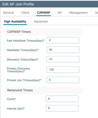

Hi, so we have a central 9800 controller in AWS and APs in Flexconnect mode running in our offices. They are switching traffic locally and using IPsec to reach the WLC. Our main SSID is dot1x and using central authentication with ISE also in AWS.
The issue occurs when e.g. an ISP fails in an office and the APs get disconnected from WLC. If the issue is not longer then couple of minutes the APs usually reconnect back and everything is fine. But if its longer the APs don't reconnect and at this point only PSK wifis work, dot1x stops authenticating new people. Retransmit timers under AP Join profile are set to max (Count: 8, Interval: 5 sec), afaik this cannot be set to more. I don't understand why the AP doesn't keep looping indefinitely with the reconnection attempts, or at least have an option to set this.

I'm trying to find a way how to reconnect AP back to the controller after it has been disconnected for longer then e.g. 5 min. Right now only option I see is developing a custom script that will track WLC logs and then after some timeout go to switch/AP and reboot it. Which seems like an overkill, hard to fine tune and hard to administrate in the future. Is there some integrated option that I'm missing, how do you guys do it and has this been an issue for your deployments?

We have 2 controllers in N+1 setup, both added as primary and secondary in the AP join profile and also configured on each AP itself. Also we use dhcp option 43 to point to the primary controller IP when booting up, nothing else.

Meanwhile if this is the case that the AP keeps trying to reconnect to WLC indefinitely, what is the purpose of these retransmit timers:
Well that timer is in place for a reason, but maybe you have other issues on the FW.  Maybe check for stale entries or if the FW start blocking the discovery requests.  There are ports that need to be allowed for the timers to function as intended.
