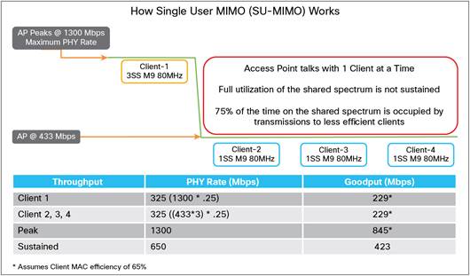

    SU-MIMO Operation

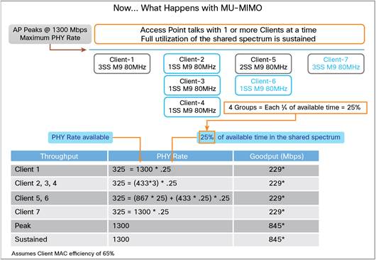

MU-MIMO Operation
MU-MIMO is a challenging technology to implement correctly and won’t be available in the first wave of AP products. And even when available, MU-MIMO does come with caveats.
Figure 8 shows one piece of the puzzle. To send data to user 1, the AP forms a strong beam toward user 1, shown as the top right lobe of the blue curve. At the same time the AP minimizes the energy for user 1 in the direction of user 2 and user 3. This is called “null steering” and is shown as the blue notches. In addition, the AP is sending data to user 2, forms a beam toward user 2, and forms notches toward users 1 and 3, as shown by the red curve. The yellow curve shows a similar beam toward user 3 and nulls toward users 1 and 2. In this way, each of users 1, 2, and 3 receives a strong copy of the desired data that is only slightly degraded by interference from data for the other users.
Figure 8.      MU- MIMO Using a Combination of Beamforming and Null Steering to Multiple Clients in Parallel
For all this to work properly, especially the deep nulls, the AP has to know the wireless channel from itself to all of the users very accurately. And since the channel changes over time, the AP has to keep measuring the channel, which adds overhead. Some APs might use the higher-overhead 802.11ac sounding protocol only, but the greatest benefit of MU-MIMO comes if the AP can minimize the number of explicit sounding exchanges, such as with the ClientLink mechanisms.
Meanwhile, the client is receiving its desired signal distorted by some interference from the signals intended for other users. This interference makes the highest constellations such as 256QAM infeasible within an MU-MIMO transmission.
In summary, MU-MIMO allows an AP to deliver appreciably more data to its associated clients, especially for small‑form-factor clients (often BYOD clients) that are limited to a single antenna. If the AP is transmitting to two or three clients, the effective speed increase varies from a factor of unity[3] (no speed increase) up to a factor of two or three times, according to wireless channel conditions.
