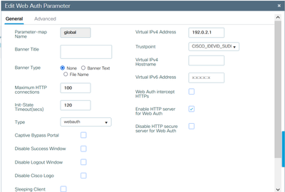

I have an existing 5520 with a guest SSID that uses web-auth. It works fine with the passthrough option. Clients are redirected to a web page hosted externally. they click a button and gain access.
I am trying to recreate this with a 9800 v17.9.4a, however the 'passthrough' option is not available.
In web-auth I have:
global:
I have also created a 'guest' parameter map using content type with the URL redirect detailed in the advanced tab.  This parameter map is referenced in the WLAN.
The clients get redirected to the URL, however the button click does not allow them to get into the run state.
Any help is much appreciated!

Thanks @Flavio Miranda I have checked the config in that document and all looks good. I believe my issue is specific to a remote web auth passthrough page
Yes, if you check the config and it is fine from the WLC side, the portal can be the issue

Has the virtual IP address changed? You also need the Virtual IP Hostname from memory for this to work to an external portal configured
*****Help out other by using the rating system and marking answered questions as "Answered"*****
That's a good point @Haydn Andrews . The portal currently talks to the 5520 on 1.1.1.1. The 9800 is using 192.0.2.1. Will I need to create a hostname separate to the management hostname? Then create a DNS record to point the virtual IP hostname to the virtual IP (192.0.2.1)?
