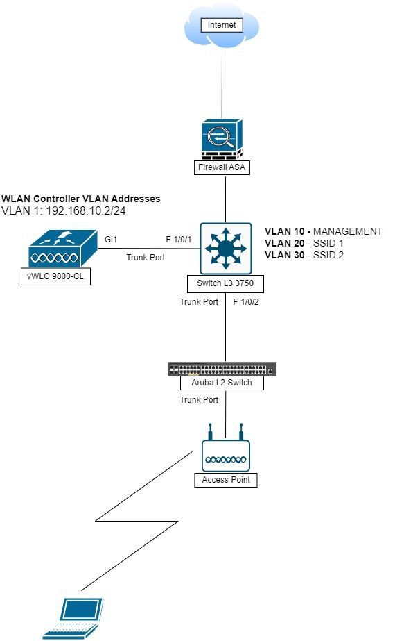

Hi everyone,
I’ve recently deployed a wireless lab using a vWLC 9800-CL, and I need some help troubleshooting Internet access for wireless clients.
Here’s a quick summary of my setup:
  • WLC 9800-CL connected via trunk port to a Cisco 3750 L3 switch.
  • VLANs:
    • VLAN 10 – Management
    • VLAN 20 – SSID 1
    • VLAN 30 – SSID 2
  • DHCP for clients is configured directly on the WLC.
  • Trunk from the switch goes to an ASA firewall that’s connected to the Internet.
  • LAN clients (wired) can access the Internet without any issue.
  • Wireless clients (connected via SSID 1 or SSID 2) get the correct IP address from DHCP, but can’t access the Internet.
I’ve already:
  • Verified VLAN tagging and trunk configuration on all switchports.
  • Ensured ASA has NAT and routing properly configured.
  • Tested connectivity from LAN clients to Internet (works fine).
My question: What additional steps should I check to allow wireless clients to reach the Internet? Is there a common issue with routing or NAT from WLC subnets that I might be missing?
Any advice or tips are appreciated. Thanks in advance!

@phuocntlk135 Again, you might never get this to work with an unsupported hypervisor.  DHCP from the controller is not recommended and you should do that from a dhcp server or your L3.  DHCP from the controller will not work if you have dhcp proxy enabled and you have a firewall.  Most firewalls don't like dhcp proxy.
