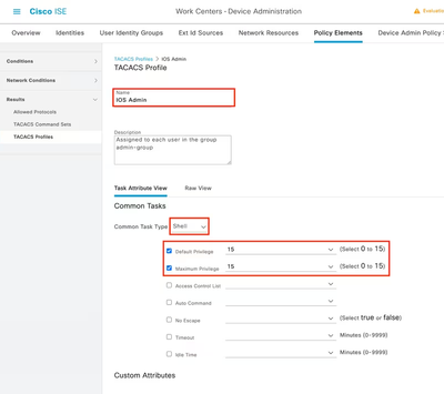

jagan.chowdam
What is the admin access level?
You can do the debug and get the user access level.
LC-9800# terminal monitor
WLC-9800# debug tacacs
TACACS access control debugging is on
WLC-9800#
Then look for "AV priv-lvl=15".
 If you are using ISE, make sure to verify the Privilege level set for admin user
Read-Only User Restrictions
When TACACS+ or RADIUS is used for 9800 WebUI authentication, these restrictions exist:
  • Users with privilege level 0 exist but have no access to the GUI
  • Users with privilege levels 1-14 can only view the Monitor tab (this is equivalent to the privilege level of a read-only locally authenticated user)
  • Users with privilege level 15 have full access
  • Users with privilege level 15 and a command set that allows specific commands only are not supported. The user can still be able to execute configuration changes through the WebUI

hello!
Tacacs did not work because of the wrong group:
I fixed it and TACACS worked.
Thank you for your time and help!
