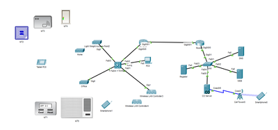

I'm using packet tracer and trying to use the WLC to configure 2 light access points however for some reason the WLC will not connect to the network. I've had it connecting before but it would never recognize either of the the lightweight access points. I've tried as much as I can think of but am not sure, I would appreciate help.
The PC is to configure the WLC and it is on the same vlan however while it can ping out to the router or other devices, it cannot ping the WLC. The router and switch also cannot ping the WLC.
I've attached the topology here and the file is also attached

Hello @andrewnagel
On MultiLayer Sw0 configure gi0/1 like this:
From PC0 you will be able to configure your Wireless LAN Controller:
Default username/password = admin/admin
