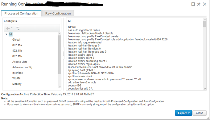

I have 2 8510 WLC boxes, diff regions, one of them is working fine,
the other one, we had a RMA, but we dont the backup from the controller itself, in other words, we never used the option down below
So we have Cisco Prime 3.0 and we have the old back up from there as the image shows:
Now, If I click on where it says: Configuration: Details,  I got the following window: 3.PNG
As you can see, there appear 2 tabs,
Processed Configuration and Raw Configuration, on the left side there is kind of the settings like you are in the WLC GUI, and on the right side there is the configuration.
In addition, I have the show running-config from Putty (but not the FTP option via GUI)
but you see what Im asking ? I dont want to go line by line or tab by tab to restore the back up, i just want to know if either way will work via the new WLC GUI
I posted because each file is different: for example one file has at the beginning config on the 1,000 lines of code
but the running config from putty and the prime file dont
I have 2 questions:
1- If I transfer via TFP via GUI in the WLC the running-config from PUTTY, will that work?
2- If I transfer via GUI from WLC the file 20190525_030400.config downloaded from the export button from Cisco Prime, will that work as a back up file via the FTP option?

HI Rasika,
I tried yesterday since I got approval from upper managers, however, the change did not work, as none of the files worked via ftp, so that means that I will have to go line by line and comparing the settings
2 things came to my mind,
1- either the cisco prime is misconfigured or it simply does not work the way we expected, I will submit a tac case to prime people to enroll well the WLC cause it does not make sense there is an initial configuration but it does not work
2- I have like 150 APs registered on the backup WLC, so while Im putting the commands line by line on the WLC, at some point during that, will all the APs will try to register automatically?
Imagine that they registered but Im still missing some configs, so I want to avoid another downtime in wifi,
or the APs will remain and keep registered while Im submitting the config commands on the new Box?
how can I ensure that once I think its ready, I can test just with one AP? or as soon the 150 APs see online the new box, they will be like crazy going and wanting to register to the new box?
