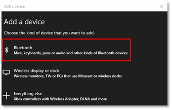

2. Connect via Native Bluetooth if your computer has Bluetooth capability.
  • Search for bluetooth on your windows machine.
  • Select Bluetooth and other devices settings
  • If your machine has native Bluetooth, turn it on, then click Add Bluetooth or other device
  •  Select the Bluetooth option
  • Put your 730 in pairing mode by holding the power slider up for 3 seconds. Select your Cisco HS 730-xxx (where xxx is the last 3 characters of the serial number).
  • You should see a success message saying that your device is ready to go
