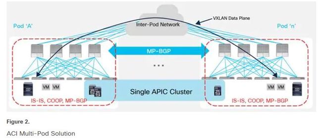

Dear @Gaurav Gambhir
What is the difference of using :
and
Using Super-Spine to scale horizontally?
