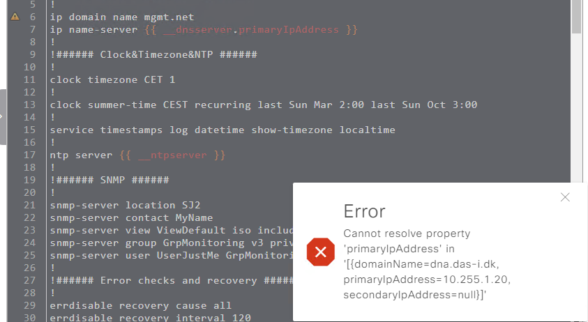

I have made an onboarding template with the following Jinja code:
{% set ifrange = 'gi1/0/1-24' %}
{% if '9300L' in __device.family %}
{% set ifrange = 'gi1/0/1-12' %}
{% endif %}
interface range {{ ifrange }}
 description *** Client access port ***
 switchport mode access
 switchport access vlan {{ VLAN }}
 ip dhcp snooping limit rate 100
 storm-control broadcast level 01.00 00.90
 storm-control multicast level 01.00 00.90
 spanning-tree bpduguard enable
 spanning-tree portfast
When I simulate this template on a device I get the following output:
!###### Access interface #####
interface range gi1/0/1-24
 switchport access vlan 99
And everything is fine.
But when I try to claim a switch with the same template the GUI stops working and I see a message in the log of the onboarding service:
2021-08-30 18:09:46,324 |  DEBUG | qtp1807648168-9146        |  | c.c.p.a.s.impl.TemplateServiceImpl | response object recieved: {"templateId":"e7cf432f-1e81-48d4-beef-12bd81c9d922","cliPreview":null,"deviceId":null,"validationErrors":[{"type":"RUNTIME","lineNumber":76,"message":"Cannot resolve property 'family' in ''"}]} |
Any help is appreciated.

I'm going to keep thinking about this and ask around, but my initial reaction is that we don't support built in variables during PnP.  The reason is that these variables all tie into inventory related databases, and since the device doesn't go into inventory until PnP is complete, you will get NULL responses when querying and field.
The best workaround I can think of so far is to create a Multi-select drop down to have the user tell you which product family it is.
It's worth mentioning though, that the best practice I recommend is to not put these interface configs into the onboarding template.  That might be why I haven't seen this topic come up before.   If you use day-N instead (by adding a provisioning step after the PnP) then if/when you need to make changes you can still use the same template.  The onboarding template should be just enough to keep connectivity to DNA center (usually to change the dhcp address to a static one on a management or uplink interface.

Preston Chilcote
Hi Preston
Thank you for the reply.
It makes sense that the information is not available before the device is added to the inventory.
It would be great if the GUI showed that these variable was not available during onboarding.
Is there any documentation describing this?
I am not sure I am convinced the variables are a good idea to use at all. It seems like there is a lot of strange things happening with them.
And then again. Doing a simulation of the following code:
{% for server in __ntpserver %}
ntp server {{ server }}
{% endfor %}
Gives me this result:
ntp server 10.10.8.1
But when deploying the template to a switch the generated config is:
ntp server
That is curious behavior, but you actually don't need those variables at all.  When you do a day-N provision, then all of the Design settings for the site are automatically provisioned for you.  It is redundant to put them in your template.  This is what the "Network Settings" section of the Summary step of the Provision Devices workflow is trying to communicate... it just doesn't tell you the exact commands that Cisco DNA will provision.
One thing I noticed though was that my ip name-server was not configured from my design. It is configured in my design for the site. And I tried to reprovision the device from inventory but that did not push the name-servers.
To confirm my sanity I tested provisioning of ip name-server with this helpful eem applet so I can see what Cisco DNA is doing:
vent manager applet catchall
event cli pattern ".*" sync no skip no
action 1 syslog msg "$_cli_msg"
I can confirm that ip name-server is applied during provision as I set it up in design settings.
*Sep 17 18:08:56.224: %HA_EM-6-LOG: catchall: no ip domain name
*Sep 17 18:08:56.230: %HA_EM-6-LOG: catchall: ip domain-lookup
*Sep 17 18:08:56.239: %HA_EM-6-LOG: catchall: ip name-server 4.4.4.4
This was also reflected in the configuration preview that you can select when you "Deploy" the provisioning task.
However, on a subsequent provision of the same switch, unless I change the name server in design settings, there is no name-server config applied.
Hi Preston,
I had to check as well after you post.
It seems like the ip domain name and ip name server are not pushed during Day0 but only if you provision the switch manually afterwards.

The configuration beeing applied on the switch:
No startup-config, starting autoinstall/pnp/ztp...
Autoinstall will terminate if any input is detected on console
Autoinstall trying DHCPv4 on GigabitEthernet0/0
Autoinstall trying DHCPv6 on GigabitEthernet0/0
         --- System Configuration Dialog ---
Would you like to enter the initial configuration dialog? [yes/no]:
Acquired IPv4 address 10.254.0.53 on Interface GigabitEthernet0/0
Received following DHCPv4 options:
        domain-name     : dna.das-i.dk
        vendor          : 5A1N;B2;K4;I10.10.8.10;J80
        dns-server-ip   : 10.255.1.20
        si-addr         : 10.255.1.20
Press RETURN to get started!

The name-server is missing but if I provision the device after the initial Day0 provisioning, the name-server is pushed according to my design.
This should be fixed by CSCvz08038 - "Cisco DNA Center - Template System Variables don't work without brackets" in the next release, but there is a workaround using __dnsserver[0].primaryIPAddress.
If this is just a bug then that makes sense. Thanks Preston.
