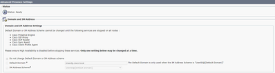

Everything looks fine. But we are getting communication an error with the server like above image.

Hi Nithin,
Are you able to login to self care portal or Im  for this user   using username and password ? Do I need to give access to each and every users who planned to use Jabber? This user cannot log into the IM server using his user name and password.
Can you post manual configuration you did on jabber. ?
