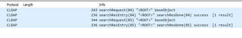

Recently we have migrated our CUCM 10.5 cluster to LDAPS .But it looks like Jabber client machines are still communicating to LDAP server via port number 389 .Do we need to make any changes on jabber client.

Thanks Roger .Tried this steps .Still jabber clients communicates to LDAP server via port 389 . Can we block this from jabber configuration file?
Created new service profile and tried jabber phone only mode .That also didn't help .It looks like Jabber client automatically discovers the directory .How to block this
