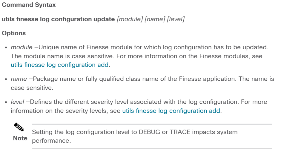

I was able to get the debug logs using the command from Cisco Finesse Administration Guide, Release 12.6(1)

I tried the command "utils finesse notification logging enable" on my DevNet sandbox for Unified Contact Center Express 12.5-SU1  but it did not work. It turns out that the command from Cisco Finesse Administration Guide, Release 12.6(1)  works for 12.5. I used the update config command and now I can see openfire set to DEBUG level. I'll try the same on our PBX.
