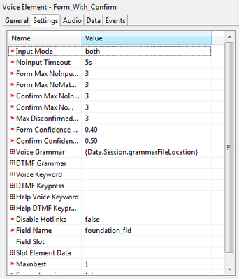

Hi All,
I set the form element exactly according to the guide document.
The URL also works well.
But, the following error log is generated and I don't know the cause.
Please let us know if any one can help me on this
[error log]
192.168.230.175.1542774660443.39.test,11/21/2018 13:31:00.474, The error was: A built-in element encountered an exception of type com.audium.server.voiceElement.ElementException. At least one grammar setting should be configured for Form_01 voice element per language.

Caused by: com.audium.server.voiceElement.ElementException: At least one grammar setting should be configured for Form_01 voice element per language.
at com.audium.server.voiceElement.form.MFoundationForm.addXmlBody(MFoundationForm.java:866)
at com.audium.server.voiceElement.VoiceElementBase.getVoiceElementResult(VoiceElementBase.java:746)
... 27 more
Quigath
For the grammar setting, I've always used the shortened version with just the url and no semi-colons. Not sure if that helps your situation but it could be something to try.
