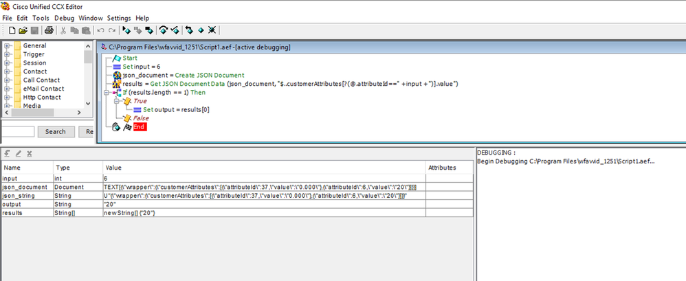

In the UCCX script I get the following message:
I know that UCCX uses the jayway implementation of JSONPath (from the previous post: @Anthony Holloway
 https://community.cisco.com/t5/contact-center/get-the-length-of-a-json-array-in-ccx/m-p/3907604/highlight/true#M112496), however link for the test is not available.
I think the error is inside the filter “[?(@.attributeId==6)]”, since for the JSON path – “$.hits.hits[0]._source.customerAttributes[1].value”, the UCCX returns me the value "20".
Any idea?
Thanks in advance.
Best regards,
Tom C
Anthony Holloway
Your JSONPath looks right, but the error you got gives a clue that you needed an Array, instead of a String to stuff the results in.
This is talked about in the JSONPath documentation here:
When evaluating a path you need to understand the concept of when a path is definite. A path is indefiniteif it contains:
  • .. - a deep scan operator
  • ?(<expression>) - an expression
  • [<number>, <number> (, <number>)] - multiple array indexes
Indefinite paths always returns a list.
Source: https://github.com/json-path/JsonPath
Now that we know that, we can use a String Array to stuff the search results into, and then if the result set length is 1, we have our match.

Anthony Holloway
Thank you, Anthony. That is exactly what I was looking for.
I have to test this on a bigger JSON file with a different kind of data, so we will see how it will go.
BR,
Tom C
