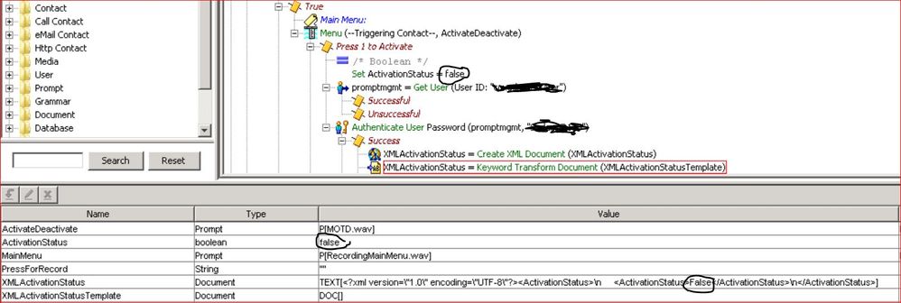

Hi Mike, Thanks for your reply. I tried the upload step, but only blank document get uploaded.
I would like to know whether my script configuration is fine or not.
Below is my Template, I would like the change the value "%Manual%" to True of False.
Screenshot of my Script.
Please help me as I am stuck at this point from last one month. TAC also not providing any solution as TAC is not responsible for any new configuration.

I tried as per your suggestion but again blank file get uploaded. There may be something wrong in my configuration. Either in the Variable or in the script. When I enabled reactive debug everything seems to be right. However still blank file get uploaded. Any Idea what is wrong in my configuration. Activation.JPG
ActivationStatus variable should be a string with just the text false, not an actual boolean value
XMLActivationStatus , Create XML should not be the actual XML, but DOC[XMLActivationStatus.xml] - a reference to the doc already uploaded to CCX.
Same for the template, you should have a copy of the XMLActivationStatus.xml, but with %value% in the ActivationStatus tag. That way when you perform the transform, it knows where to place the variable.

Hi, Though this is an old thread, i have tried this now and replying with my worked script for future reference.
Hope this image explains.
I am uploading OriginalXML as OriginalXML1 to avoid confusion, we can use same name as OriginalXML for uploading document, no issues.
Authenticate the user with credentails having admin rights. Enter the user name and its corresponding password.
