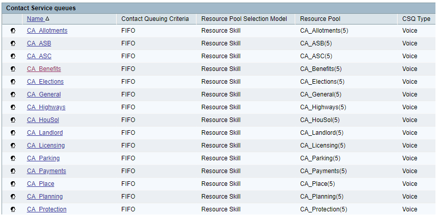

Paul Edwards
Thanks for confirming my thoughts @khorram1998, i have triple checked the 1 to 1 relationship between CSQs and skills (see attached). In the meantime, whilst this issue has been present, we have reverted back to adding/removing skills using Admin> Resources. Just a shame as our supervisors were looking forward to being able to utilize the advanced queue management features.
