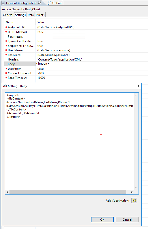

Send POST via CVP Rest Client element with CDATA in body
Calladot
I rty to send POST request via CVP Rest Client element with body:
<import>
<fileContent>
<![CDATA[
Phone01
0631231212
</fileContent>
<delimiter>,</delimiter>
</import>
, but I receive
400 Bad Request - javax.xml.bind.UnmarshalException
 - with linked exception:
[org.xml.sax.SAXParseException; lineNumber: 1; columnNumber: 1; Content is not allowed in prolog.]
In wireshark I found that request is not complete
Have you set the Content-Type Header?
Can you also try without the CDATA format.
i.e. here is a very similar example - which I know works perfectly. (I use this to insert a callback into the Dialer).
Regards,
Gerry

I believe you have an error in the XML formatting ?
Have you tested the format and got it to work outside of  CVP, e.g. in Postman?
Gerry
Yes, postmen send full request. And all works fine.
Regards,
Gerry
Thanks, it works without CDATA.
I also implement callbacks and I just didn't know that it was possible to do so.
