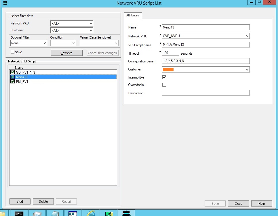

In the attached Network VRU.jpg, it shown the menu configuration.

1051573: 10.222.77.13: Nov 22 2017 15:57:51.869 +0800: %CVP_11_5_VXML_SERVER-3-CALL_ERROR:  RunScript Error from CVP-IVR [MEDIA_RESOURCE_ASR(31)] CALLGUID: 96786AF3CE9111E7BF142C5A0F4DF880 DNIS= {VRUScriptName: 'M,-1,A,Menu13' ConfigParam: '1-3'} [id:3023]
