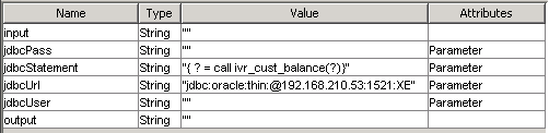

Then I added the following variables to my UCCX script:
  • input - type String - initial value: ""
  • jdbcPass - type String - initial value: the password
  • jdbcStatement - type String - initial value: "{ ? = call ivr_cust_balance(?)}"
  • jdbcUrl - type String - initial value: the JDBC URL
  • jdbcUser - type String - initial value: tthe JDBC user
  • output - type String - initial value: ""
Or, if you prefer a screenshot:
Then I just inserted a Set step (setting the value of the variable input to "33333"), followed by yet another Set step which assigns the value of output and contains the following code block:

Now if you run this and the DB server is available, after the second Set step the value of the output variable is "12345":

I assume your DB function takes one parameter and returns one value - is this correct? If so, you need to change the initial value of jdbcStatement to
"{ ? = ivr_package.ivr_cust_balance(?) }"
And if the input parameter value is stored in the local variable named ivr_cust_id then the code block of the Set step would be:
