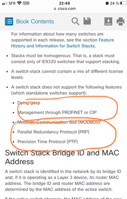

Well, I may have answered one of my own questions:
Apparently Stackwise stacking disabled protocols PTP, PRP, and CIP on the IE-9300.  At least in the current firmware.
We are having the same Industrial Protocols over IE9300 conversation with Cisco.
https://www.cisco.com/c/en/us/td/docs/switches/lan/cisco_ie9300/software/17_7/redundancy-protocol-config-ie93xx.html
When IE9300s are Stacked they lose a bunch of Industrial Protocols [as of 2025]: HRP, PTP, PRP, Fast Rep, MRP, yada....

Albert Mitchell
PTP over IE9320 stack is on the roadmap.  No time frame for release.
will ensure dual GNSS receiver is covered and if not it will be documented.
