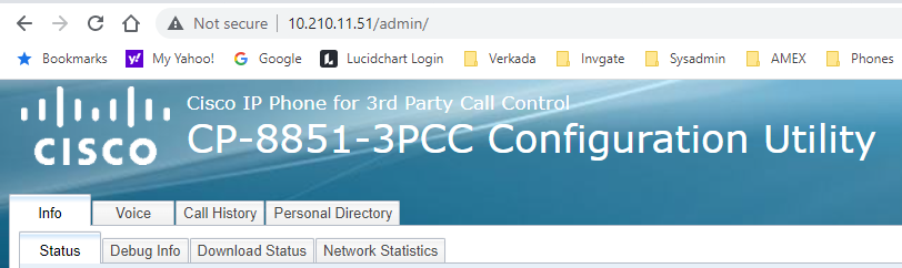

Option 150 is setup in DHCP and the TFTP server is working.  I was able to connect to the web interface on the problem phone.  The UI is totally different from any other 8851 on our network.  It shows Cisco IP Phone for 3rd Party Call control.  I tried a factory reset and it made no difference.
This is the web interface on the non-working phone that is asking for an activation code.
This is the web interface from a working phone on the network.
Working phones on the network are all running 14.x firmware whereas the problem phone is running an 11.x firmware.  I am thoroughly confused as to how this thing went from a normal working phone to this 3rd party stuff.
OK, then it makes sense it only asks for the activation code as that's meant for Cisco Webex and MRA is not used.
But yeah, that doesn't happen automagically, there's a whole process you need to follow to migrate from enterprise FW to 3PCC/MPP firmware along with a one time/one way use license you need to get that enables the migration. If you're interested, see details at upgrade.cisco.com
That FW is not meant for CUCM, it's not supported to use that kind of FW on CUCM, only on 3rd party PBX or Cisco Webex.
I'd discuss with whoever gave you that phone what they did, because this doesn't just happen without user intervention.
