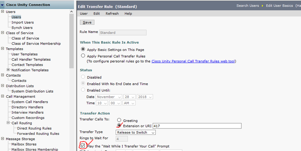

Just sharing my thoughts here. I am thinking of once the phone did not answer after a period of time, call will go to voicemail (Unity), then voicemail will play greeting that says "the call is being transferred…", then you will be transferred to a Call Handler that transfers the call to your destination. Not sure if this is an appropriate solution as you need to configure each users with Call Handler to transfer their calls and any forwarding details will be done from Unity, not from Call Manager.

This is not naively Possible in CUCM but we can use the Cisco Unity Connection for the same.
So you have to transfer the call to unity connection and there we configure the number to which you want to transfer the calls.
I have tested this in my setup
1) Set the Call forward Busy/No Answer to Voicemai in CUCM
2) In Unity Connection go to use account and in Greetings and Set the call to be transferred to Transfer Rules of same account.
3) Then go to transfer rules of same account and set the number you want to forward to.CUC-2.PNG

End user can use the Unity Connection PCA Portal to update the call Transfer Rules. So a little User training should be enough for the same.
