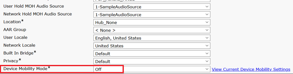

On a specific phone, under Device Information you may change the "Device Mobility Mode" to "Off" and then press "Save" and "Reset" the phoneDevice Mobility Off.png

I changed "Device Mobility Mode"  to off and the restarted phone but again time is incorrect, it differs only 4 hours.
