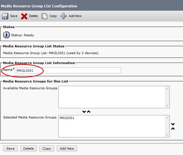

Hold and transfer are supplementary functions, if they are not working this could be due to MTP not being allocated for the call. Can you check MTP required on the gateway / trunk and reset it and see if it works. Also, ensure that MTP resource is added in the MRGL assigned to the gateway / trunk.

Thanks man, I made MTP between my router & cucm but the problem does not solved.
