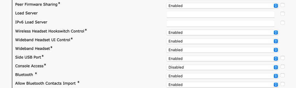

I use ELECTRONIC HOOK SWITCH CABLE to connect my CS520 with 8851 and it works perfectly. below mentioned cable was used to connect the headset base with the phones.
U need to enable Wireless Headset Hookswitch Control on phone when using this cable.
and bottom of the base station there is two button which u need to adjust for  better voice.
