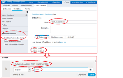

I have a question about Endstation Network Conditions for IPv4.
I have configured “Network Conditions>>>Endstation Network Conditions>>>created „TEST_ENDSTATION” and added the address IP 10.50.50.10 or alternatively 10.50.50.0/24.
In AUTHORIZATION POLICY I have the condition „Network Conditions: TEST_ENDSTATION”.
Start endstation authentication/authorization with the address IP 10.50.50.10 (tested for MAB and DOT1X) is not matched with the prepared condition. I read that I need to add a command on the switch, but it doesn't help:

If I add MAC to Endstation Network Conditions >>> TEST_ENDSTATION MAC, then the authorization works correctly and goes to AUTHORIZATION POLICY condition "Network Conditions: TEST_ENDSTATION MAC".
So for MAC it works for IP it doesn't work.
What do I need to add to the switch configuration so that the IP address is sent in the network attributes?

Hi @newjard ,
 the Endstation Network Conditions is based on End Stations that initiate and terminate the connection. In a RADIUS Request, this identifier is available in Attribute 31 (Calling-Station-Id). Calling-Station-Id is commonly the MAC Addr of the connecting Endpoint.
 At Work Centers > Profiler > Endpoint Classification, check the attributes captured by the RADIUS Probe of the selected Endpoint, verify the Calling-Station-Id info.
Note: the Framed-IP-Address value populates the IP attribute.
Hope this helps !!!
Thanks for the answer.
In my endpoint authorization's ISE logs I have:
--------ISE LOGS--------
Authentication Details
Endpoint Id: MAC ENDPOINT
Calling Station Id: MAC ENDPOINT
IPv4 Address: 10.50.50.10
Other Attributes
EndPointMACAddress: MAC ENDPOINT
Called-Station-ID: MAC ENDPOINT
-- I can't see Framed-IP-Address --
In ISE TCP DUMP in wireshark I can see Framed-IP-Address:
AVP: t=Framed-IP-Address(8) l=6 val=10.50.50.10
Type: 8
Length: 6
Framed-IP-Address: 10.50.50.10
At Work Centers > Profiler > Endpoint Classification I can see:
Calling-Station-ID: MAC ENDPOINT
Ip: 10.50.50.10
We do not use Profiling.
The authorization rule with IP_ENDPOINT still does not match.
What else could be the reason?
What can i check?
Based on the definition, the only parameter that is checked when you select Endstation Network Condition and using RADIUS-based authentication is "Calling-Station-ID". Based on your experience, the MAC address restriction works but IP address does not. This is normal because "Calling-Station-ID" contains the ip address of the endstation when the endpoint is using AnyConnect VPN to access the network.
