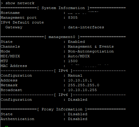

You change IP of mgmt so you have access to console
Can I see
Show network

So I didn't actually set this up myself, but I just figured it was configured for local as we don't have an FMC.  I also ran these commands.
I entered the debug http 255 command, but I am not sure how to use this.
