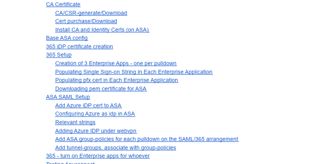

DIANNE DUNLAP
We do have this working in the lab with multiple tunnel groups - the certificate business was tricky but instructions are at https://docs.google.com/document/d/10lfDCcEawWu5_T66V70r9IUr1s2suSQLkqDaX1y3b8w/edit?usp=sharing
ASA Anyconnect Remote Access via 365 ASA Anyconnect Remote Access via 365 Introduction Background Network Design Firewall DNS FQDN Firewall Clock CA Certificate CA/CSR-generate/Download Cert purchase/Download Install CA and Identity Certs (on ASA) Base ASA config 365 iDP certificate creation ...
