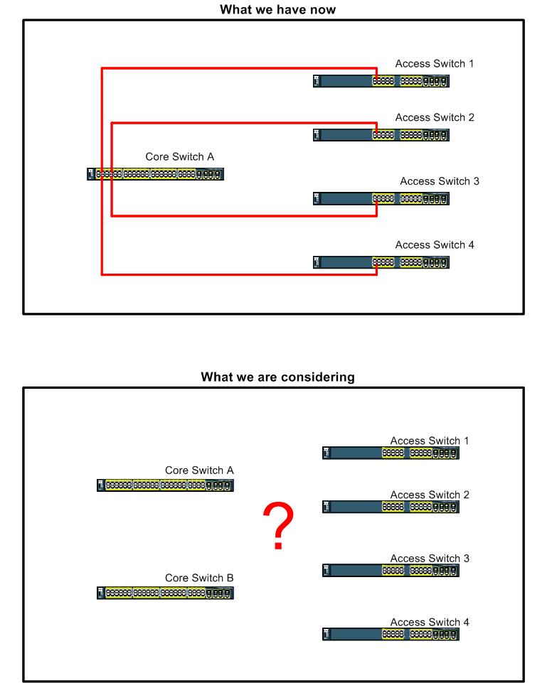

We have a 48 port 2960G switch distributing our LAN to numerous 24 port 2960G switches.
We have been talking about bringing in another 48 port 2960G switch for redundancy.
Can someone please let me know what the best design options are for this setup, in terms of redundancy and possibly even load balancing? I am interested to find out what Cisco technologies/features are recommended in this situation.
I created a quick drawing of what we currently have and what we are thinking about. None of these devices have been put into production yet. Let me know if you have any questions, thanks.

Edison Ortiz
I recommend running 4 links from each access switch, 2 links going into each core switch.
Configure the dual links going into each core switch with etherchanneling.
Etherchanneling provides LB/FT.
Read all about Etherchanneling @
http://www.cisco.com/en/US/products/hw/switches/ps679/products_configuration_guide_chapter09186a008007f723.html
Additionally, configure each core switch as spanning-tree vlan # root primary | secondary.
Please rate helpful posts.
Thanks

Thanks Edison, but a few questions...
Why no link to connect the two core switches together?
These are all gigabit connections, so I think the "dual links" might be a bit overkill in our specific situation. Besides, I might have a few access switches that need to have all the ports populated already as it is.
Would the UplinkFast/BackboneFast features be something that I should look into as well?
Yes, I forgot interconnecting the 2 cores.
Go with 2 links with etherchanneling configured.
As for uplink/backbonefast, I recommend enabling uplink on the access switches and backbonefast on the root switches (cores).

ajagadee
First and foremost, good thinking :-) Its good to have redundancy.
1. Two uplinks to the distribution switches from the access layer switches.
2. STP - Hardcode your bridge ID and make sure that for certain vlans Distribution Switch A is the primary and for certain vlans Distribution Switch B is the primary.
3. One port from the access layer switch is going to be in forwarding mode while the other one is in blocking state. In case of the primary path failure, Spanning Tree will recalculate the path to the root bridge and start forwarding traffic.
4. Also choose the right STP Technology for your environment.
