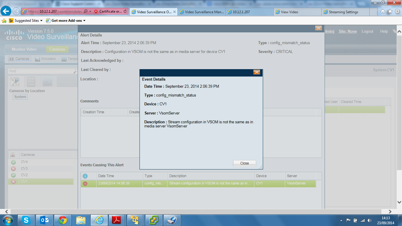

We are trying to install a VSM 7.5 with 4 attached cameras (2 x 6000P & 2x4500E).
I have installed all servers into the same virtual machine, and this virtual machine is located alone on a physical server (C220 M3) (Media Server & Management Console & Operations Manager)
the 2 x 6000P cameras are working fine, but we cannot setup the 2 x 4500E Cameras.
They both have an error: config_mismatch_status
Please help

, but we can see the logs into Operations Manager. I deleted the camera, and then added again (same error):
