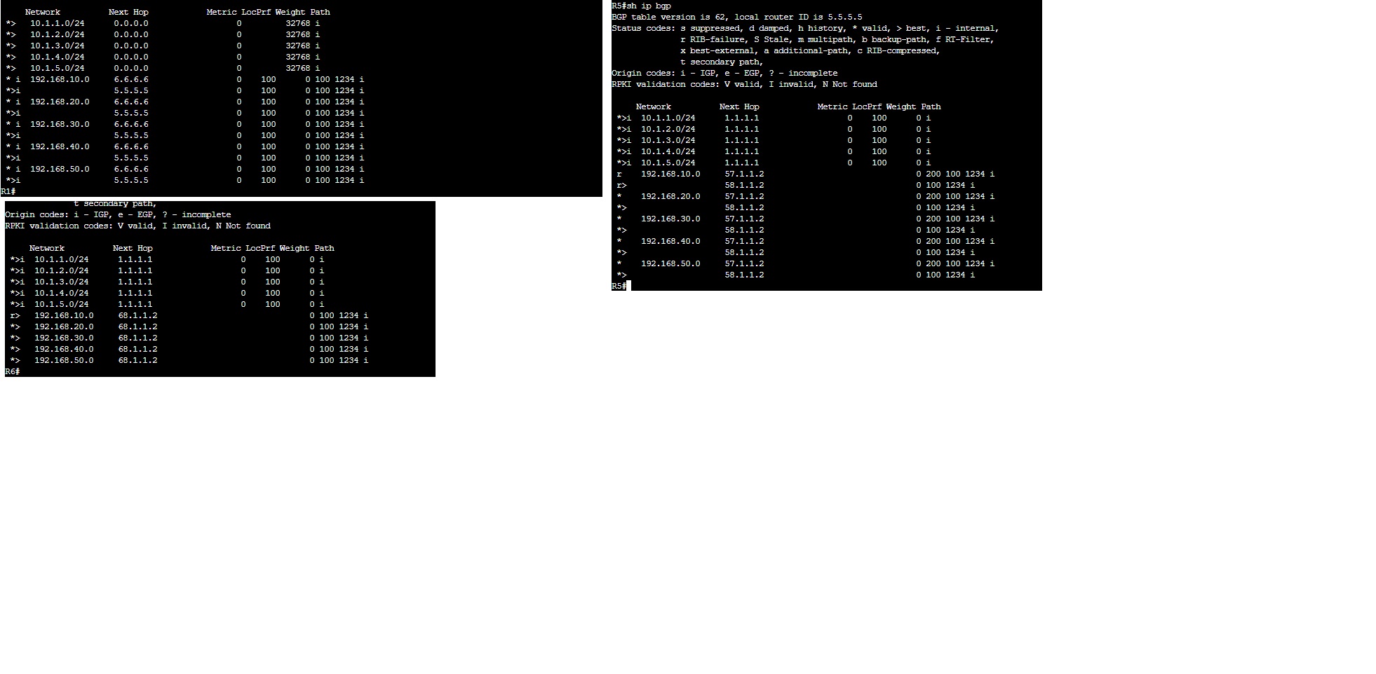

Hello, I'm having issues with my BGP configuration where I have used the next hop self command on my border routers which now display itself as the next hop to its IBGP neighbors in the internal routing table via BGP. Also, the destination router outside the AS as learned via BGP routes to Loopback networks on my IBGP router but they cannot PING. My topology have 6 routers in OSPF 1 Area 0 with complete reachability, and 3 routers (R-1,R-5, and R-6) configured in IBGP advertising it's loopback (1.1.1.1, 5.5.5.5, and 6.6.6.6 - AS 100) using the meshed OSPF as it's underlay. Routes to destinations are reachable via OSPF but not BGP thought both BGP in each AS has valid routes.
I have 3 routers in separate AS advertising routes to IBGP following this video: https://www.youtube.com/watch?v=c7kTbjSZwgs&t=764s

Yes sir, I have confirmed each loopback from R1 (1.1.1.1) to R6 (6.6.6.6) all have reachability. Loobacks for R1(1.1.1.1) R5 (5.5.5.5) and R6(6.6.6.6) (IBGP AS-500) have reachability using OSPF as IGP. Routers R2(2.2.2.) R3(3.3.3.3) and R4 (4.4.4.4) are not participating in BGP however, have reachability via internal route.

I've sourced the ping with my loopback of R1 to destination 192.168.10.1. On R1, both route tables have the route to the destination with "sh ip route" displaying routes learned via BGP with next of of R-5 and R-6 as they have been configured with "next-hop-self as iBGP peer to R1 (1.1.1.1).  R9 (AS1234) advertises the 192.168.X.X networks to R5 and R6 via BGP. Again, applying the next-hop-self to R5 and R6 allowed advertisement to R1 to learn the External (192.168.X.X) networks

I've sourced the ping with my loopback of R1 to destination 192.168.10.1. On R1,  Source on R1 was 1.1.1.1?  if so, does R9 has route to 1.1.1.1 of R1 loopback ?   192.168.10.1. belongs to R9 , right?  do ping 192.168.10.1 source 1.1.1.1, what is result ?
turn on ICMP debug on source and destination routers; also do traceroute source destination and check results. (or debug icmp on all routers)
