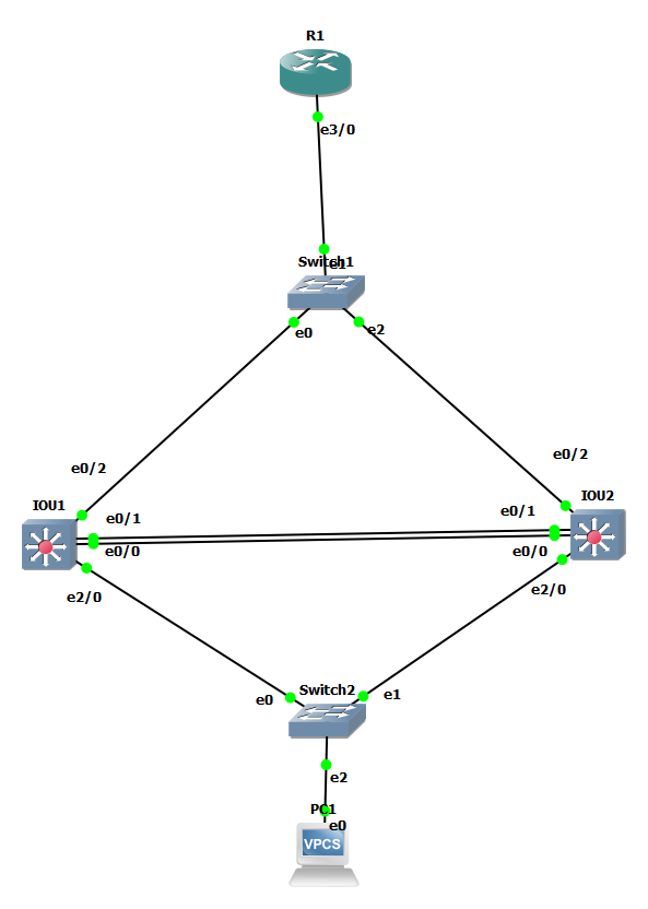

I am trying to just connect two layer 3 switch together where int e0/0 and e0/1 is set as trunk port and e2/0 as access port of vlan 10 in both switches. After configuring this I always get this error message and I want to ask is this a big issue if it occurs in production ?

"After configuring this I always get this error message and I want to ask is this a big issue if it occurs in production ?"
Depends what you're trying to accomplish. Normally such an error message would indicate a configuration error, which is why the other posters consider such a configuration as "wrong" or "bad".  However, there might be some (highly unusual) reason you need to do this.  If so, you either live with lots of these error messages or you disable CDP on the "problem" port.
BTW, the error message, itself, would also appear wrong, assuming your posted configs and network diagram are correct.  Why?
Well, the error message is flagging interface e2/0 on both switches, but those interfaces connect to Switch2 and are both configured as access ports using VLAN10.(?!)
Also, on IOU2's e0/0 and e0/1, you have the native VLAN as 20, but your only
permit VLAN10
on the trunk.(?!)
