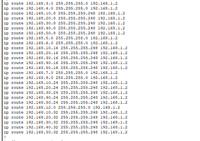

On your router R1 simplify your static routes:
By one default static route:
ip route 0.0.0.0 0.0.0.0 192.168.1.2
Same things on Router R5. For others Routers, static routes are OK, since you have East and West traffic.
