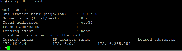

Unsurprisingly, querying the pool on R1 reveals the following:
The server is assigning addresses as expected. But the client still has not received an IP address!
For the sake of brevity, the only changes I did to make it work was to add a route back to the 172.16.0.0/16 subnet on router 1. Only then was the client able to get an IP from the scope defined on the pool. (See complete logs below).
