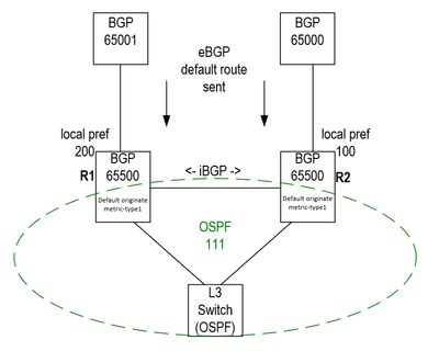

Our leaf set up is fairly straight forward. We have two routers at each leaf site for redundancy that receive a default route from our hub router via eBGP. Router1 is the "primary",  we use local preference of 200 on it. Router2 is the "secondary",  we use local preference of 100 on that. Both routers have OSPF for the igp for iBGP reachability, they are directly connected and peer with their loopbacks. OSPF is configured on both routers to advertise a default route via default-information-originate with metric-type 1 for the downstream L3 distribution switches. Here's where things get strange and we have this deployed at many sites....
-At some sites Router2 will prefer the default advertised from Router1 via iBGP.
-At some sites Router2 will prefer the default advertised from Router1 via OSPF.
In the configs nothing has been changed to tweak a routing protocols admin distance. There is not PBR or any otherwise config that would cause this. They are identical configurations aside from IP addresses quite literally.
I would expect that Router2 prefers the default route from Router1's OSPF advertisement since local preference on Router1 is higher, this iBGP route is the preferred BGP path on Router2. The iBGP (200 AD) route would not be installed in the routing table since there is OSPF route available (110 AD). With that said I can't imagine any scenario that would cause the iBGP route to be preferred over OSPF at some sites, especially when I look at the tables they look nearly identical aside from the ones preferring OSPF show a rib failure in BGP which is to be expected. What's going on here or have I forgotten something about OSPF and BGP's relationship?

Thanks David, but to your point about local preference not being used that is what it is using. It is the first decision it is making since one of the iBGP paths has local preference of 200. The route is sent by the hub, it is also received by the leaf, see the outputs I provided. The OSPF database does have both routes in it. See my diagram hopefully it clears things up.
So I had some time to lab it up. Minimal config but same concept. If R1 and R2 are learning the default route from an eBGP neighbor then they will use that respective neighbor for the default route since the AD is 20. The fact that R2 is using R1 for its default route at all suggests that its not getting a default route from its eBGP neighbor. I agree with you higher local preference is preferred but this should not apply if everything is working as it should. Local preference applies to iBGP peers. Which means in order for local preference to take effect you would first have to lose your eBGP peering and your OSPF peering as their ADs both beat out the AD of iBGP. I’m still trying to understand your topology and what is iBGP vs eBGP.

Here is my lab:
My R3 is your R2 in this case.
Once I killed the link to R4 and it lost its eBGP neighborship the OSPF default route took over
-David
David, with respect I understand your point but you keep missing R1 and R2 both receive a default, but R1 has added local pref 200 the the default it receives by design. Recalling BGP compares local pref in the path selection process as the 2nd, R2 will choose the path R1 has since it has higher local pref. As far as the topology clarification R1 and R2 are iBGP, the routers with different AS's are eBGP. The default is sent from AS65002 to each hub.
